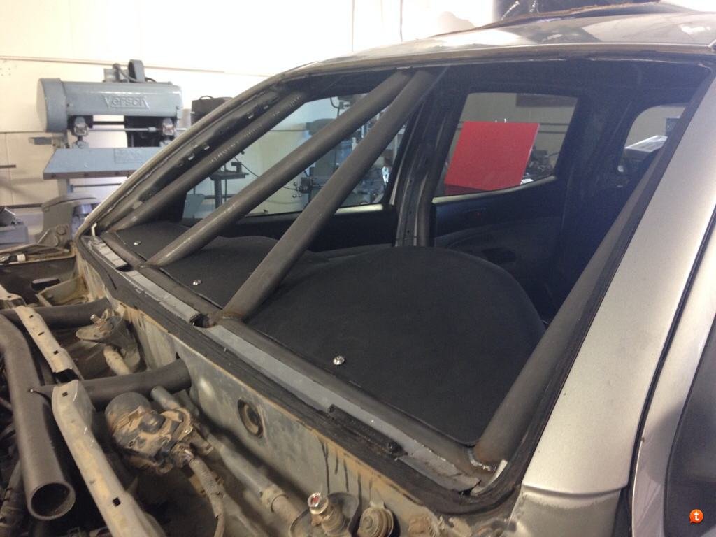

    Whats up guys..i know some of you have seen it on Instagram/My build but LSK recently finished caging my truck. We did a cab cage with four seats connected to a full engine cage(Yes the windshield wipers still work :D), connected to a front bumper. Anyways heres a few pics, more in my build. Just wanted to share the great work LSK Suspension did for me

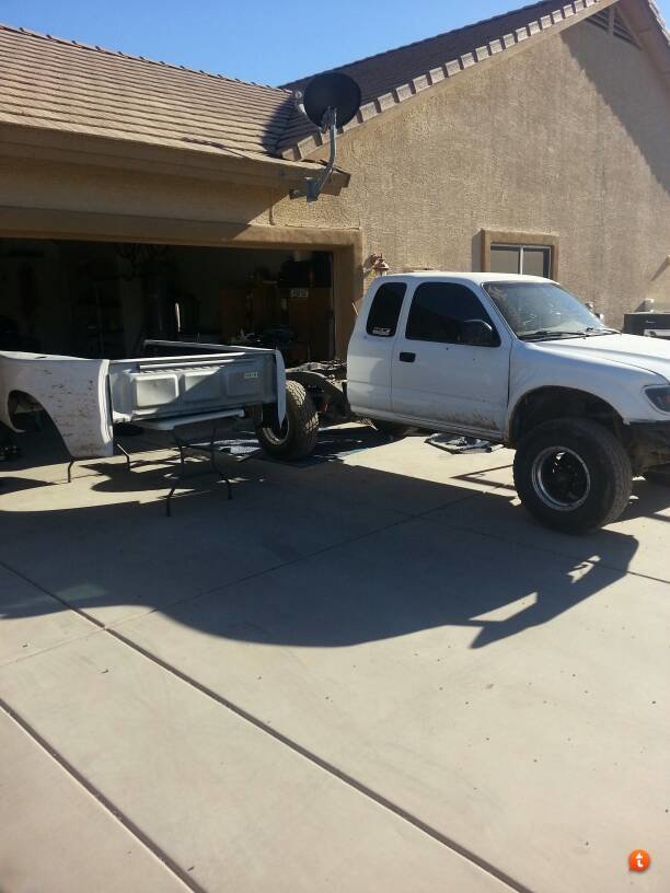

    Well i started my sua today. Taking things apart now. Any advice from you guys? 4emera4e_7d0d242303da63b7609cf4ae5902eecef08ec686.jpg

    Cool! I'm interested to see a better shot of the dash. Did they just cut slots in it for the cage?

    I believe its called Longacre? Ordered it from SDHQ Vince on here
    Yup, rolled dash tube and cut slots for the tubes. It bolts on like factory and they added three screws to the top for added rigidity. Is this what your looking for?
    Heres a progress pic from a few weeks ago. They got the dash to fit smoother after this was taken too.

    Brace the frame in a spot that wont affect your mocking up of the shackles, Drop the tank, and grind all the existing suspension mounts off clean.

    I ordered the trail gear box kit and it doesn't fully fit. Too much gap in some spots to get it welded.
    Got everything tacked up and cycling it now.

    Cory got the same kit for his and it fit pretty ehhhh
    Just grind it down a bit and split the difference
