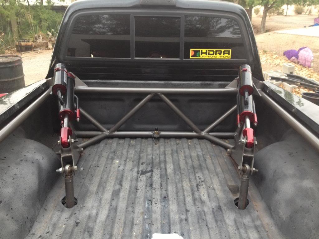

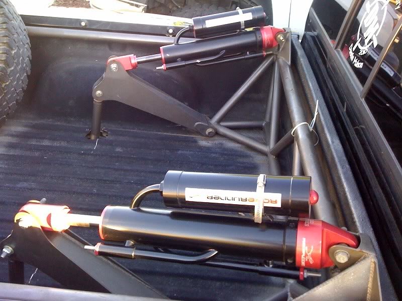

    What's the point of that? Most people run cantilever kits under the bed to save space. He could have just ran a traditional hoop and shock.

    Looks sick but what are the travel numbers

    What I thought too. Or hell just link it

    maybe he already had a set of 10s lying around and didnt wanna buy 14 or 16s for hoops. or with a 10 he is yielding similar numbers than with bigger shocks. isnt the ratio like 2-1 for cantilevers opposed to 1 to 1 for hoops?

    Ratio varies depending on a lot of factors.

    Yea the ratio changes from set up to setup. Depends on shock length, travel numbers, and a few things that are beyond me. Lsk built mine at around 2:1 with a 10" shock and 16" of travel strapped

    This truck is now owned by a guy on ig @ohsnapitseddie I'm sure he's on here but don't know his name. Sick truck!

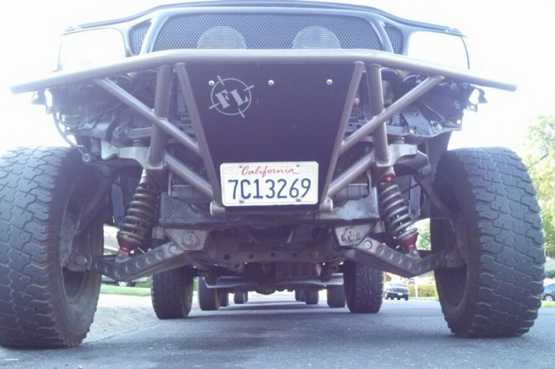

    it's the old frontline fab tacoma. karl built it above the bed for shits and gigs and it's kinda cool to watch the suspension at work. he built the front kit too. that trucks changed owners quite a bit from when it was built. i strongly considered buying it a year or so ago when it was for sale

    Yup it's got blue wheels on it now but otherwise the same. He just posted a vid looking in bed from tailgate view of the rear working, pretty sick!
