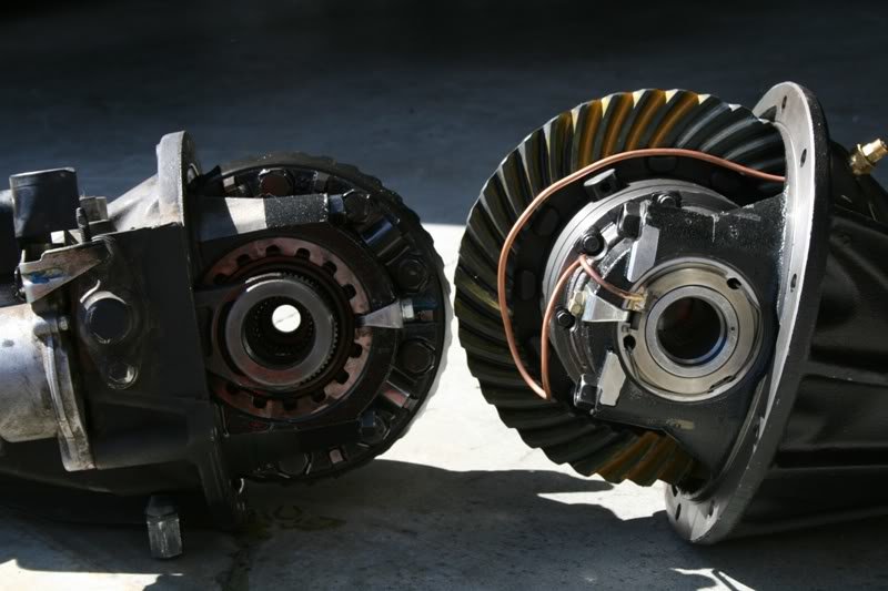

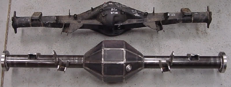

    Taco 8" on the left, Landcruiser 9.5" on the right.
    You don't lose any ground clearance with a fabricated Diamond 9.5 housing
    The pinion length is the same so the stock driveline will fit
    it has an E-brake, and disk brakes a proportionate size
    it's full floater
    All parts (except for the axle shafts) can be ordered online or at a toyota dealership
    It's almost as strong as a Dana 60 which has a 9.75" ring gear, with half the weight and certainly stronger than a 9" at about the same weight.
    Good locker selection. I chose a Detroit for reliability. I love my ARB up front but it's easier to protect the air line on IFS than a live axle.

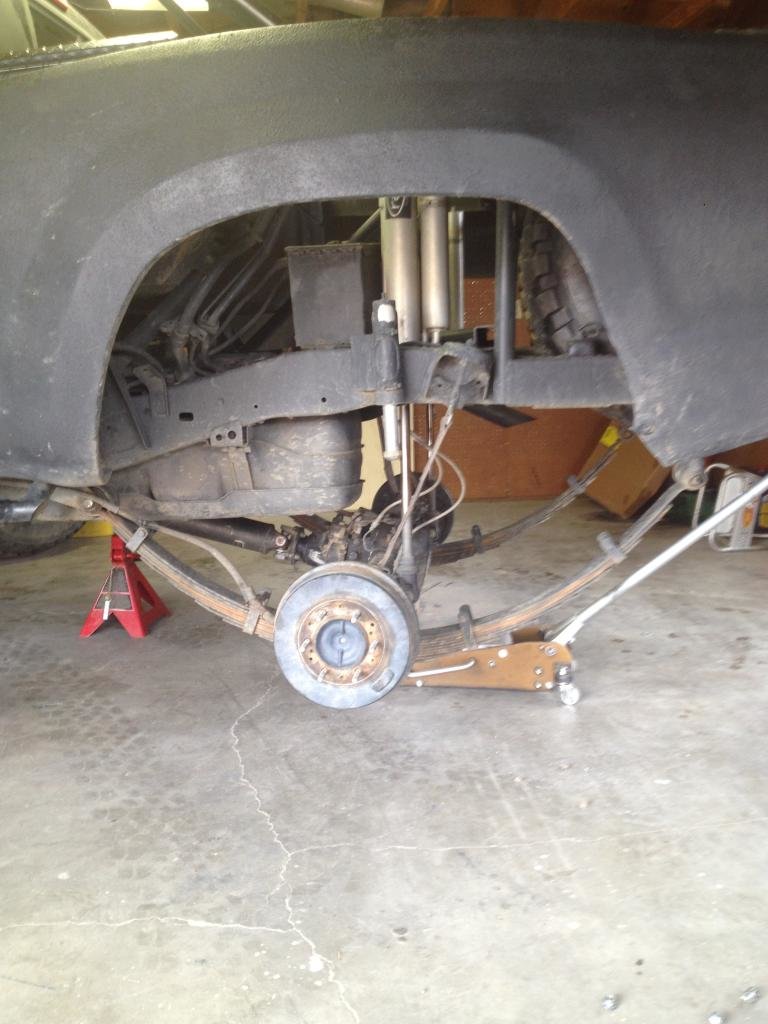

    Starting the rear tear down
    540ADD83-050D-4291-9C70-ACBA62EEF0C5_zps_a95f9d62d4faf5a3d5fb19ddc27bf4d24160f1c3.jpg
