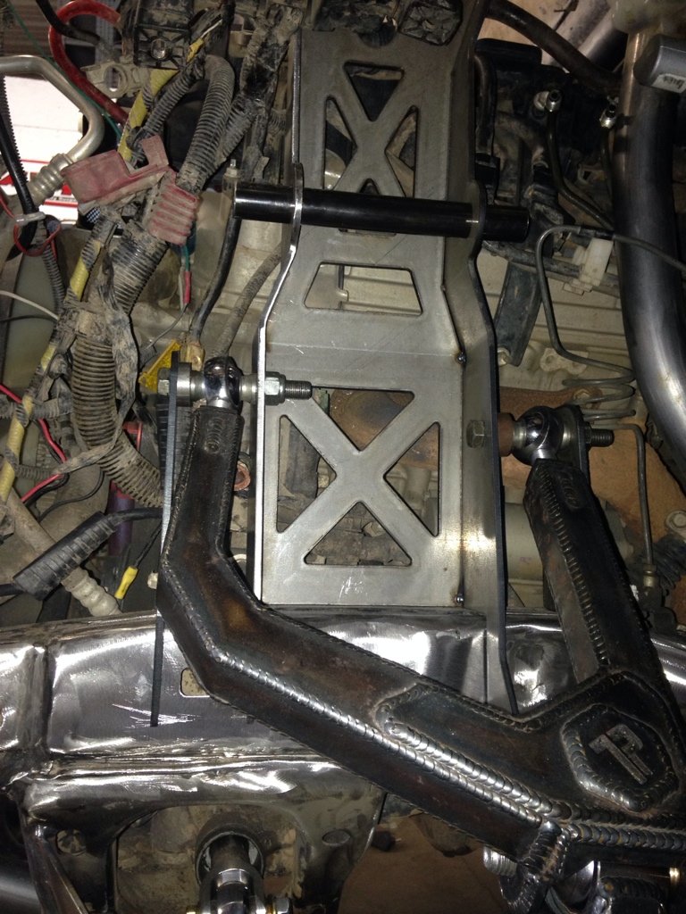

    Something we are working on

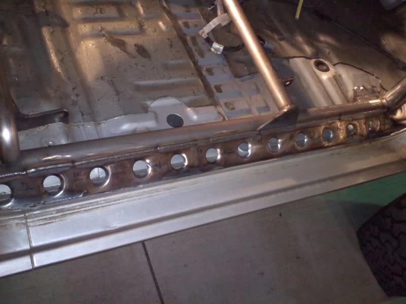

    should a caged ruck have solid body mounts? or just tie the cage to the body more? theres some cracks on the body and id like to prevent it from becoming worse

    Yes it should be on solid body mounts in my opinion and from Ive seen at other shops. And tied into the cage aswell. Caging without solid body mounts will probably lead to cracking eventually. It also causes annoying squeaks in the cab.

    ive heard it doesnt matter because tieing the cage to the body "solid mounts" it. usually see it tied to a & b pillar, door sills and back of cab.

    Exactly, as long as you floor is plated to the down tubes going though the floor, that would replace your solid mounts

    the down tubes are welded to the floor...heres the cracks
    under the door (both sides)
    should i repair these or is it not really a big deal? theres also tie ins on the a pillar and the b pillar...nothing up against the rear window though
