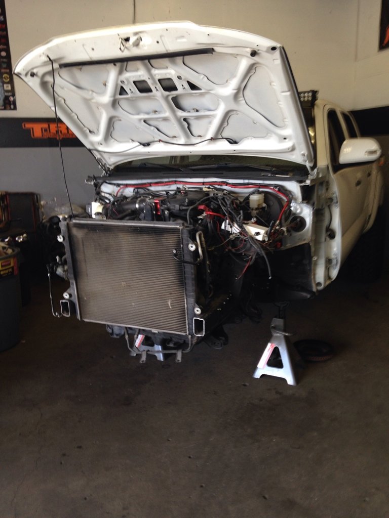

    Started another tacoma build today.

    what's the plan for this?

    4" Bodylift 20" Offroad shock spacers Turbo Encabulator

    For you 4wd guys, did you drop the front diff to weld in the DMZ motor mount gusset?

    does anyone know if the tundra axles still use the outer cv dust cover? i didnt know the new ones didnt come with them so now i dont have inner or outer dust covers...

    i would drop the diff...its not too hard

    I have the skids off and am dropping the lowers etc to do the cam tab gusset's, figured it might be a good time to do the engine mounts

    You have to drop it to weld correctly.

    I dropped the LCA's and full front diff to gusset the motor mounts. I made my own gussets though. It was much easier to get to that way.

    I didn't. I only did one side though. I had enough room after removing the axle.

    Which side did you do?
