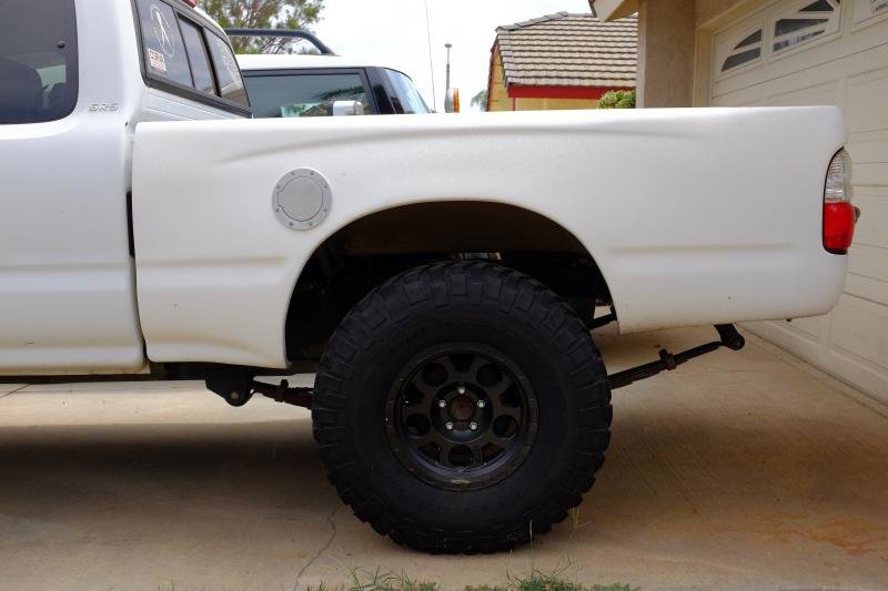

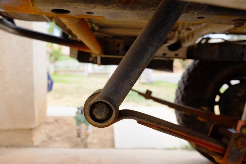

    I run Deaver 62" with a 9" shackle through the frame. I'm at 57" from front hanger to rear shackle hanger.
    Ride Height
    Shackle angle at ride height.

    sweet...anyone know the bolt size that goes through the shackle and leaf? a 22 impact socket fits on the head side but not on the other

    I believe it's a 9/16 through the eyelet on the leaf. My f67s were anyways

    hahahahaha! It's a 9/16" bolt invest in some 7/8" and 13/16" sockets ;)
