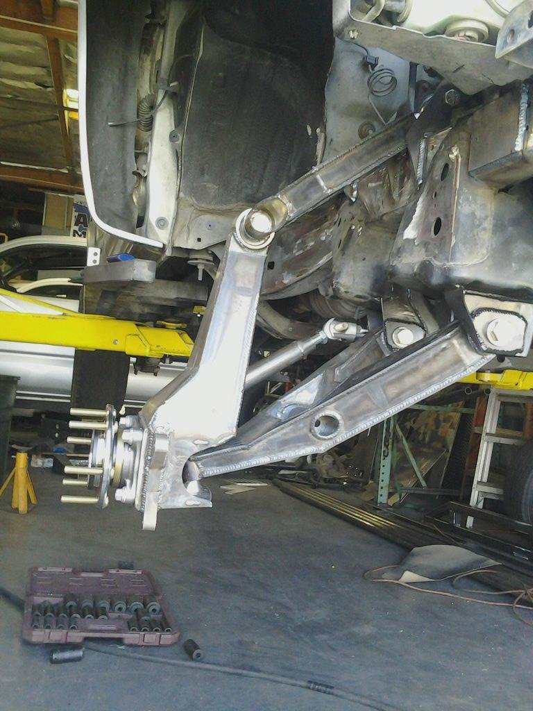

    Front long travel custom: king 10" CO, solid lowers, fabbed spindle, heimed everything ect. Rear still in progress, waiting to be put on: bilstein 9100s, T100 axle. Stock 3.4 engine, 4.30 gears.
    Anyone know a good alignment shop in the 818 simi or Ventura region?
    Someone who's can do heimed uppers

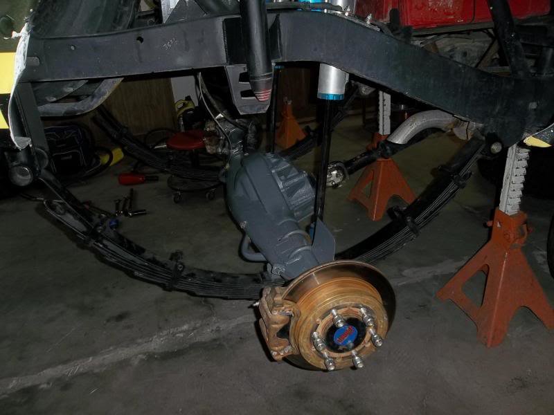

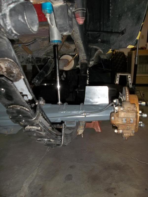

    This combo was only supposed to be a temporary setup but the rear end works so good that I have no motivation to change it up and go to a hydro bump back there. I've got the large square pyramid to work as some compression bumpstop and then made basically what's shown above with the hard rubber bumps to be my true uptravel limiter.
    Pinch bolts are towards the inside to make sure that if the tire does make it over that far in an unforeseen extreme situation there's nothing sharp for it to run against.
    Not the best photos but it's all I have right now...
