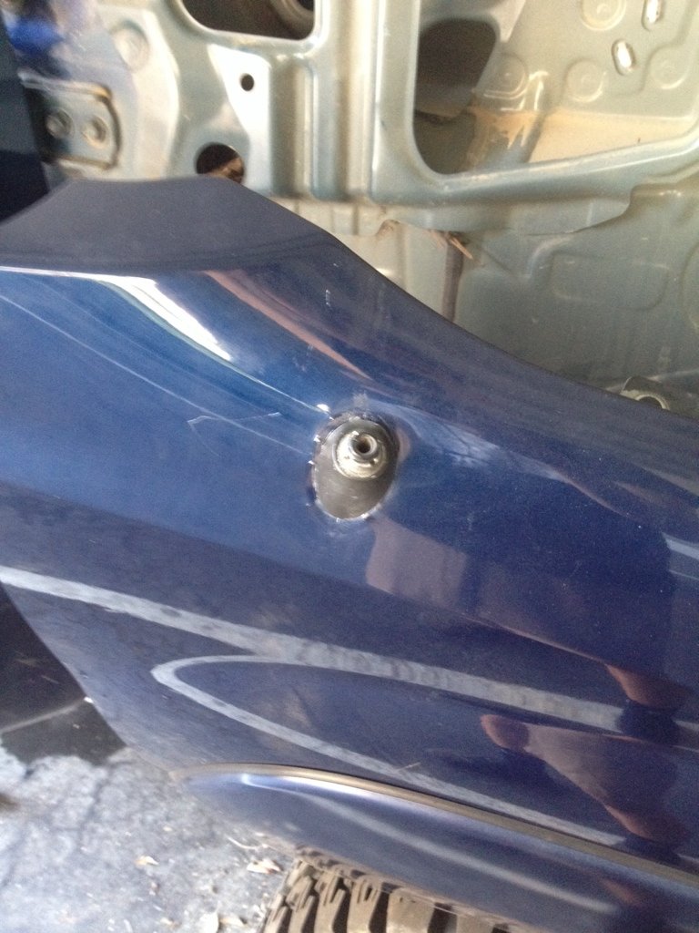

    Fiberglass fender question. Trying to take off my passenger fender but can't get the antenna mount dismounted.

    Special wrench to disconnect it.

    I'm at this point

    Just go down a 4 wheeler trail and it will break off :anonymous:

    Autozone doesn't have that wrench and a screwdriver isn't work so it looks like I might be cutting my antena

    I ended up just cutting mine. You can buy a new assembly and re route it through the old opening.

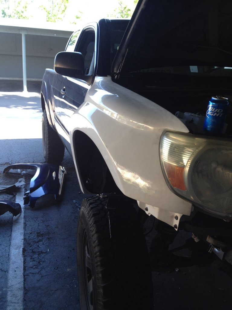

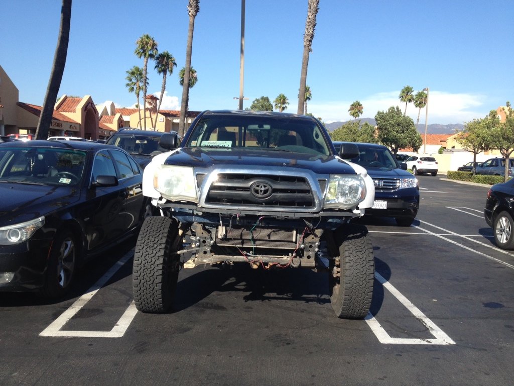

    Ended up disconnecting the cable in the passenger side pillar, everything else went smoothly and stoked on the results. 8a4a8e7u_dc3b77f3b70b930d14dcbbc2c533431ffe9a2366.jpg
    Hopefully have a new bumper and paint done by next week.

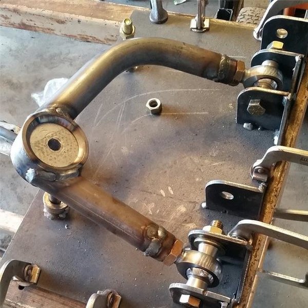

    stock length upper arm 2nd gen taco. for a buddy of mine

    If you build hiemed uppers the tubes should be parallel or it wont bolt up properly when adjusted.

    Yeah, it looks like a bump stop lol

    ^^^^, looks good though!

    Looks great. What bumper are you going with?
