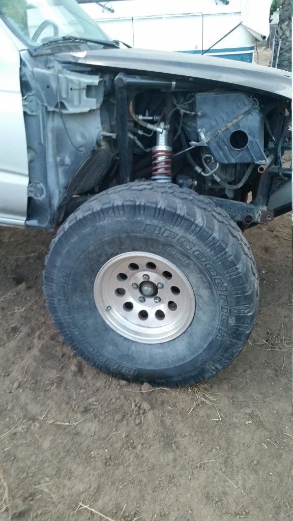

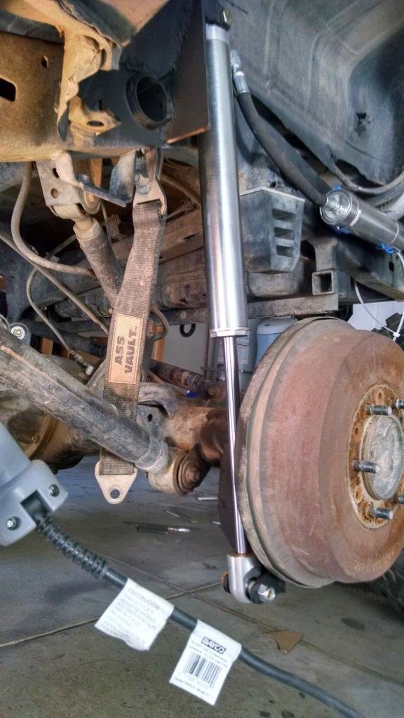

  13. Aug 24, 2014 at 10:04 PM
    troyboy162
    troyboy162 Well-Known Member
    Sep 9, 2013
    #112190
    81
    troy
    woohoo! it looks like crap but its solid. More clearence testing and straps/bump pads are needed, but I can finally driver her again.
  14. Aug 24, 2014 at 10:11 PM
    anthony250f
    anthony250f Well-Known Member
    Feb 18, 2012
    #73066
    16,778
    Anthony
    San Diego, CA
    2008 dcsb trd offroad 4wd
    why didnt you use a shorter shock?
