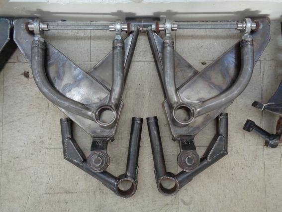

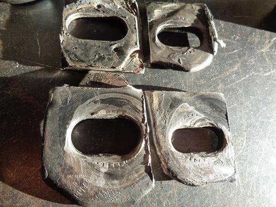

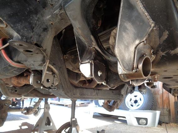

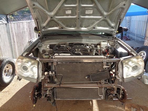

    Sick of the stock lower arm cam tabs on my 4runner so cut them out and am replacing with all 1/4 thick 9/16 bolt tabs.
    I hate running bushing inner sleeves in oval cam tab holes since you are only clamping the sleeve at the very top and bottom of the sleeve and everything gets marred up and deformed.
    Won't drive any different but will be nice for prep/maintenance and for peace of mind.
    Built a set of uppers with parallel heims since I'll be aligning off the upper now. Old ones I had converted from poly bushings so the heim angles weren't the best for adjustment.
    Waiting on fiberglass fenders still to finish up the core support...

    You know, if you'd build this shit in kit form and had an "add to cart" button I would have a lot less money and your builds would go faster. My hillbilly solution to the cam tab problem was to install nylatron bushings and weld the cam tabs solid (after an alignment).

    Ha, the tabs I used I get from poly p and cut them down to fit.
    I'm all about pre-cut tabs and brackets now, getting lazy.
    The delrin/nylatron way is good too, bushings are so expensive though.
    Kartek has some Delrin bushings that are 1.25 inner diameter that you could run 1.25" .250 inner sleeves on (for the big front cam bolt sleeve) that would have lots of surface area to dgaf about oval slotted cam tabs, but last time I checked they were $16 a half bushing.

    I used some 9/16 all thread for a pivot jig line and cut one tab out at a time. That way i always had the other tab for reference for the spread between tabs.
    Pretty tight in between tabs for the horizontal cut to get the old tabs out but I had a bunch of worn down cutting disks that fit between the two tabs, if that makes any sense.
    These are the tabs I used, I use them a lot.
    http://www.polyperformance.com/shop/Synergy-2-x-1.5-Flat-Tab-p-494.html
