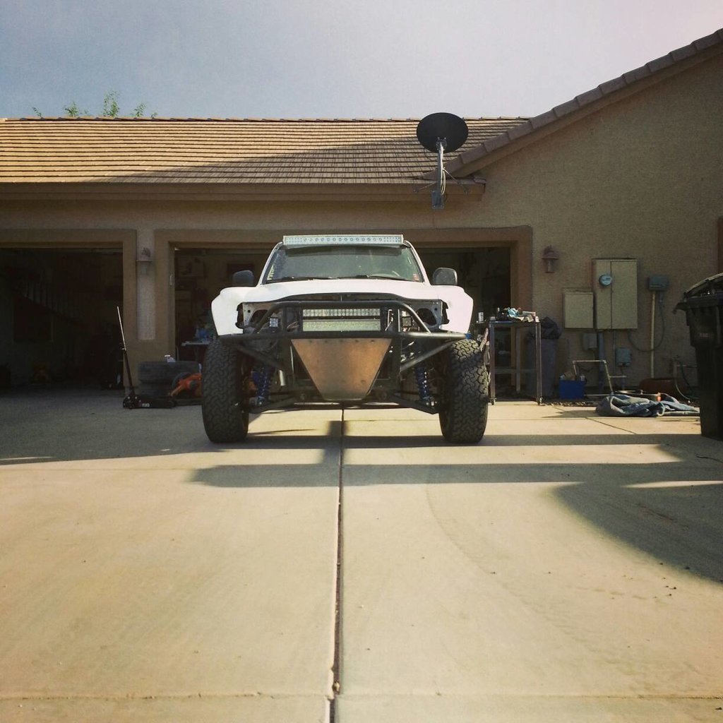

    Here is the progress on the 5lug guy 61dfe3dc96ab7ed086be29bccc501fca_cee35f090e9cbae13be2f2d0371e79324a760411.jpg

    I still don't get why people put hiems on the lower arms. Such a weak point.

    pretty sure the front mount has to be heim on 1st gen 5 lugs

    it has to have it that's why. what about lower links? is that a weak point also? it doesn't pivot on the same plain that's why it needs it. stock they run a bushing due to the low travel it doesn't need it. when you build it and get more travel you need to have the movement in the hiem to cycle right. granted the best way is to cut off the mount and not have it at a 45 degree angle and make it parallel with the rear mount. that's why the mini taco's suck to build

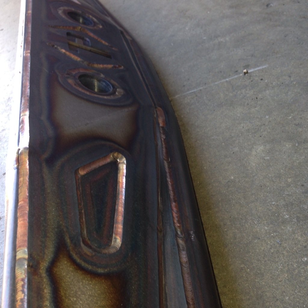

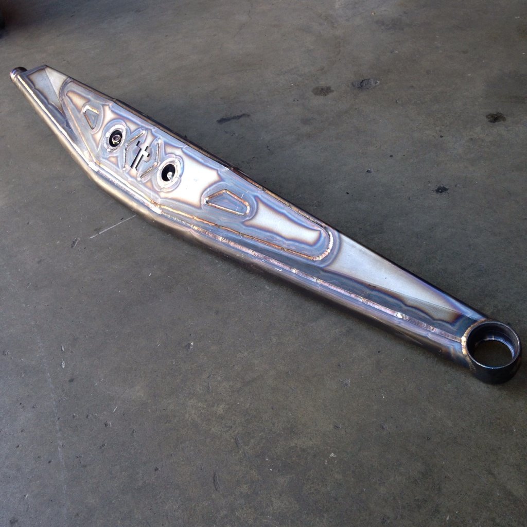

    Just finished some trailing arms

    Sweet, what are they going on?

    Sick! How much does those run?

    Pretty sure those are going on Nick Isenhouer ranger

    Needed on the 5-lug. And really, a Heim is much stronger than a bushing load rating wise. Also, more alignment. THe thing with a heim is the mis-aligns needed are what make it complicated. Look at Camburg and a few others that have Uniball as the pivots on the lowers. It's a heim without a shank. Still a spherical bearing.

    My jd fab kit uses a heim in that area. It just larger with misalignments. Even the tc taquito kit used heims. My truck is at least 1000lbs lighter too. It works fine for 5 lugs that aren't trying to be race truck or hucking off dunes. A uniball would be better, but my truck has so many more weak points than that heim.
    I'm curious how long his lower arm holds up. He is just looking to learn the hard way.

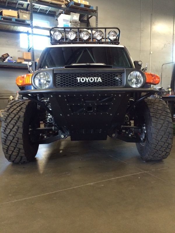

    The Fj is heading to Barstow to stretch it's legs
