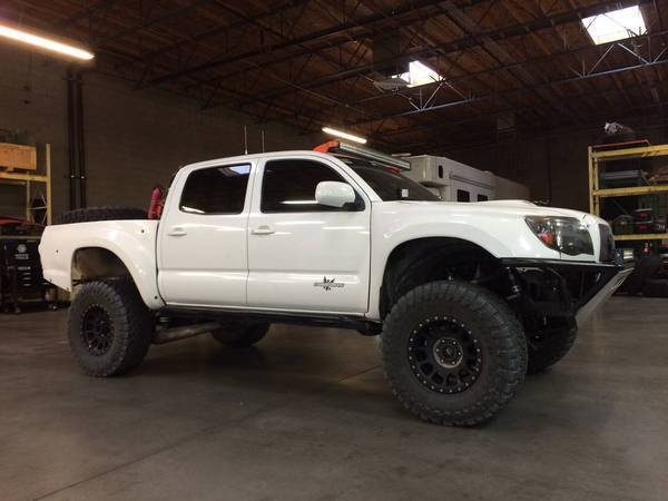

    New wheels are on their way

    Those wheels look sweet. Wonder who bough em.

    Which wheels are you getting?

    17x9 method 105s
