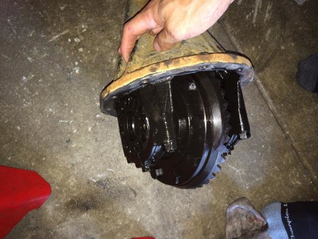

  19. Sep 17, 2014 at 1:18 PM
    Blackdawg
    Blackdawg Dr. Frankenstein
    Dec 31, 2010
    #48500
    81,627
    Monte
    Wyoming/St. Louis
    The Trifecta of Taco's
    Post a photo.
    If it's a 4runner. I don't think so. But let's see it first
  20. Sep 17, 2014 at 1:52 PM
    Anthony250
    Anthony250 Ex Fabricator
    Sep 29, 2010
    #44016
    3,775
    Anthony
    Rialto CA
    99 Tacoma LT Prerunner
    LSK Race Kit, King Shocks, Methods, Glassworks, Baja Designs, Built by myself.
    Okay here.. Probably not bridged caps.
    Another question if it does not fit. Can I use this detroit locker in my tundra diff?
