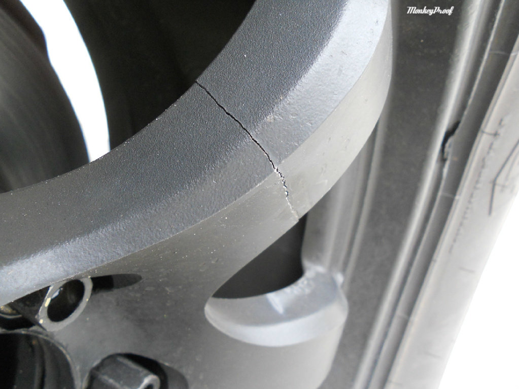

    Stay away from the Konig Countersteers, I've destroyed 2 of em...

    Woah! Guess light has it's compromises. I'd bet you push your countersteers harder than I do MP...

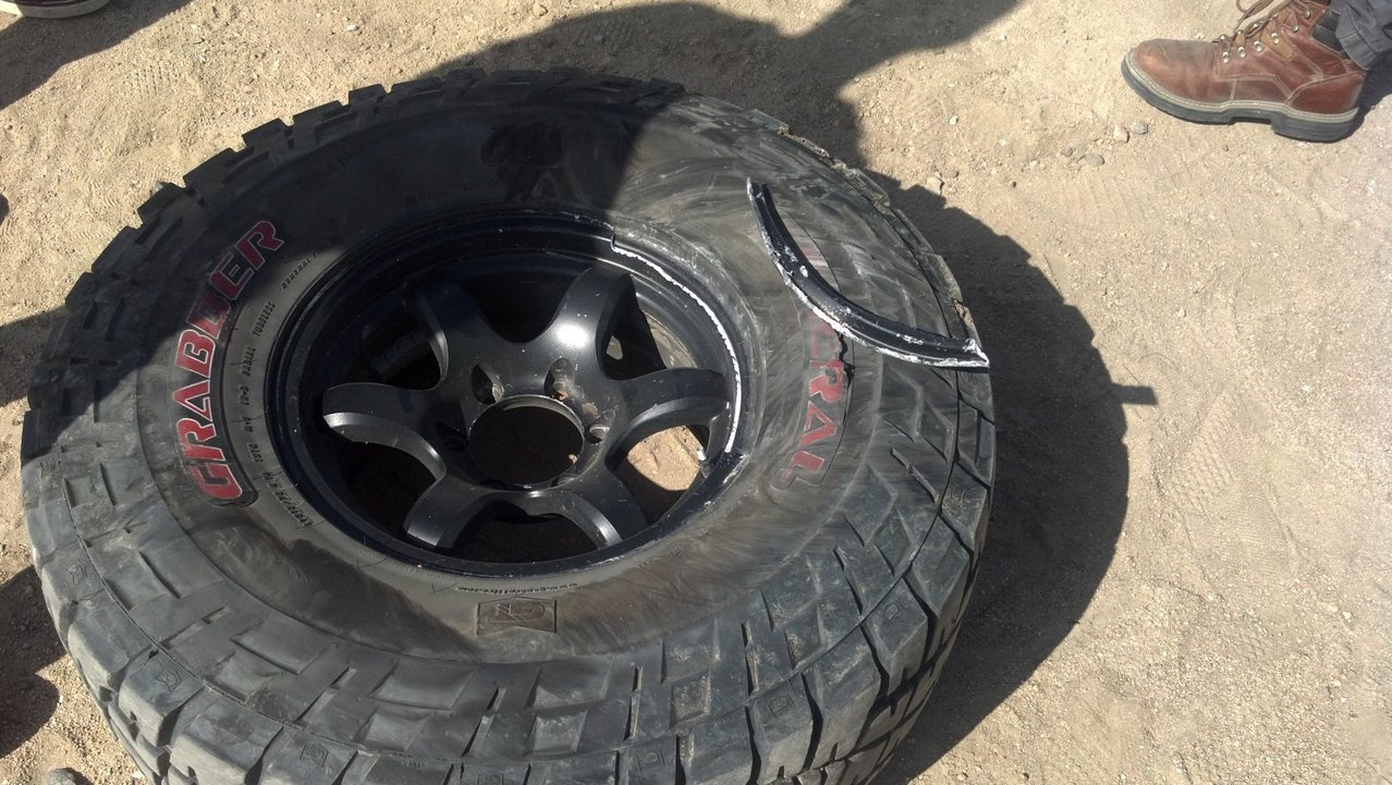

    Beadlocks are impossible to balance. They are also really heavy. When you start smashing rims like me and monkeyproof, then consider upgrading. It's harder to do than it looks. (these were Mickey Thompson classic locks, hit a basketball sized rock at speed and destroyed two of them)
