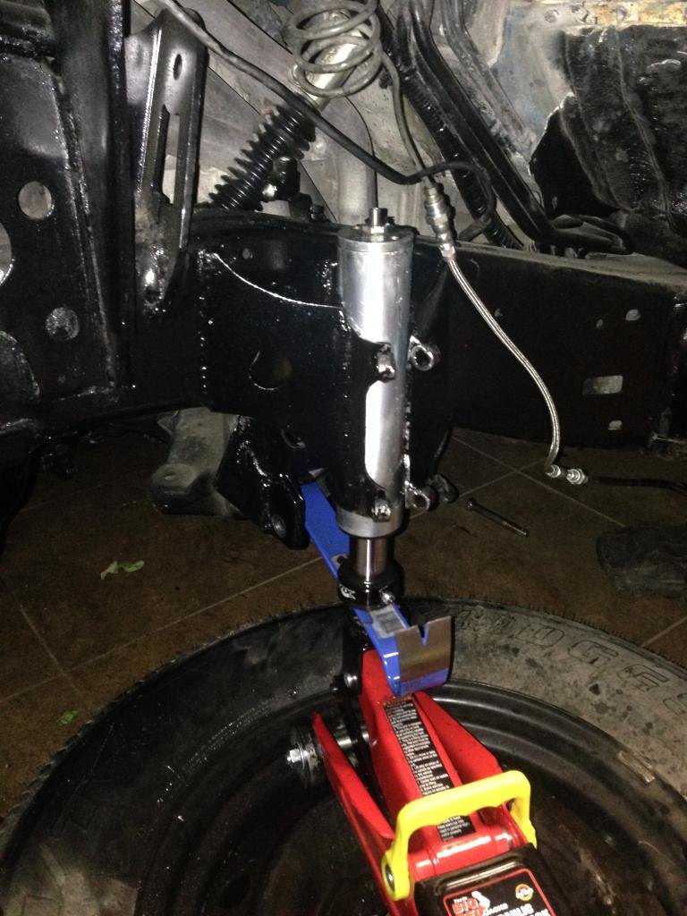

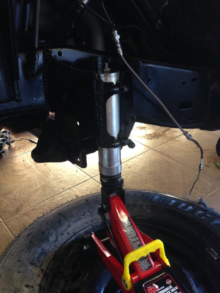

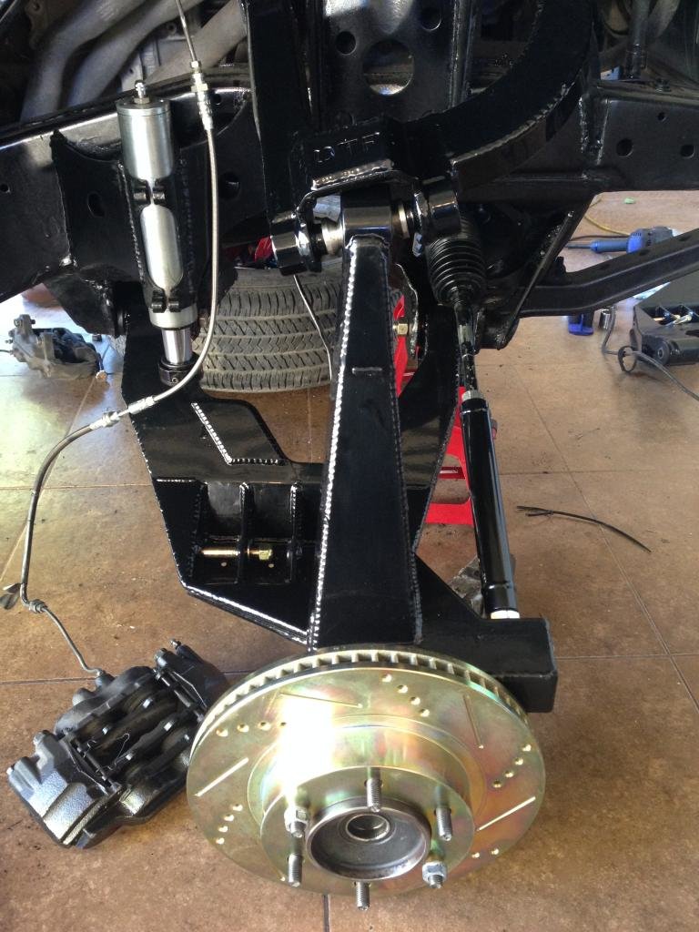

    Got one side ready with steering and rotors but can't get started on the other side because of the bumpstop
    Tried hammering it, then tried lifting it with the jack but it lifts the whole truck!

    use a pry bar and spread the can open while pushing the bump out
    or get a helper and use two pry bars.....it will work

    What Anthony said, on mine I use a chisel and a pry bar to install/remove them. I wedge the chisel in the lower pinch and use the pry bar to open the upper pinch and then do what I need to do with the bump.

    Tried with the rear part of the hammer but nothing happened, I don't have a pry bar but I'll try with a chisel if noting happens I'll go buy some pry bars.

    Finally could get the bump stop in, had to do some sort of pry with the pry bar I got at lowes (super bar) lol
