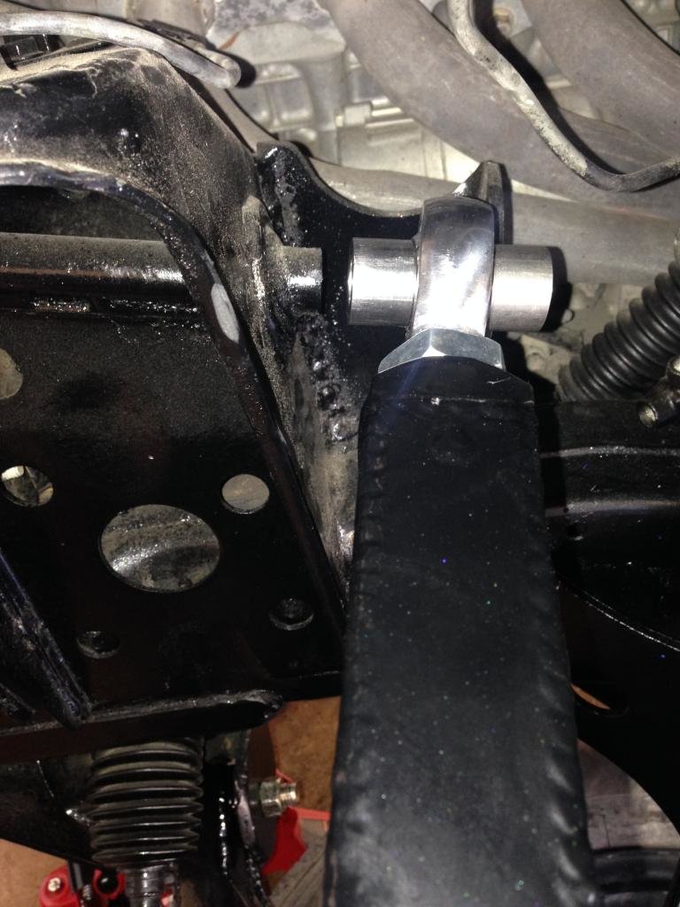

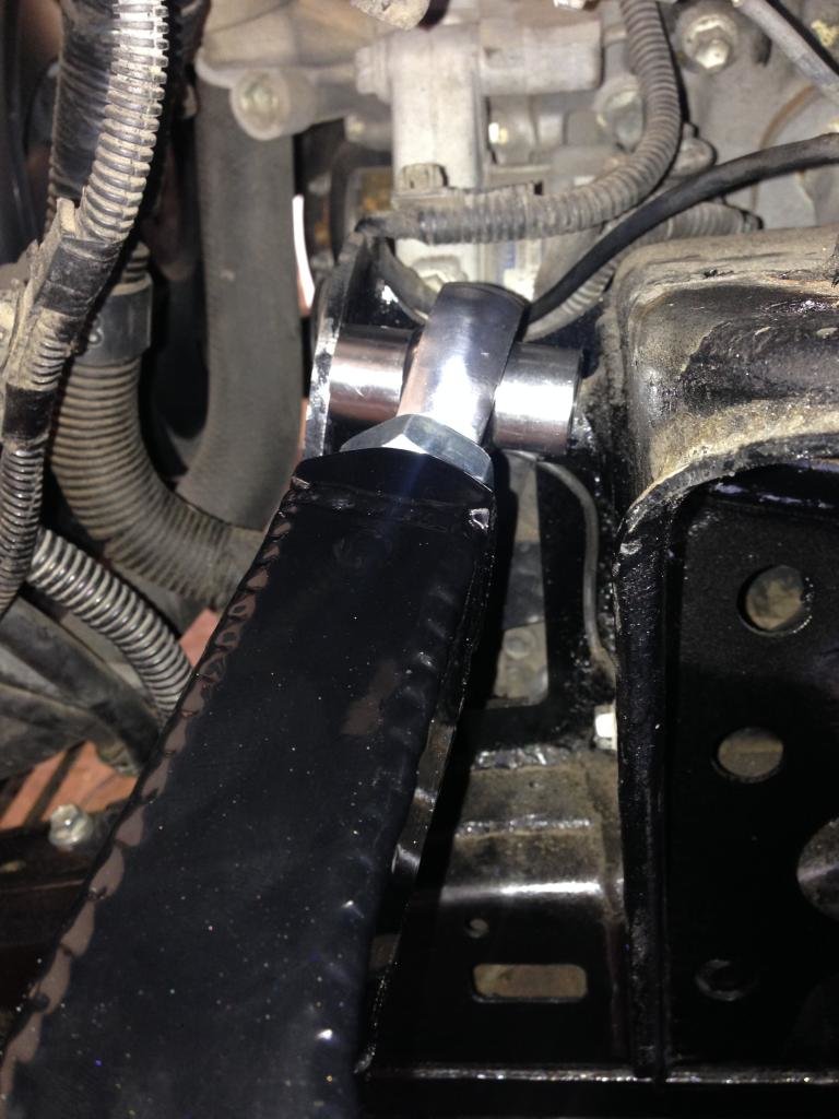

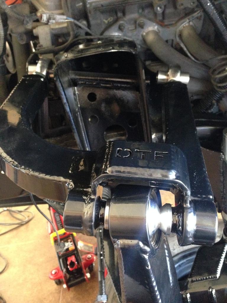

    07 DCSB LT/4LINK
    http://www.tacomaworld.com/forum/2nd-gen-builds/227832-my-never-end-build.html
    Driver's side is almost done
    Just having some issues with the UCA, spacers won't fit in

    Shit can the gussets, whip up new ones after the uca is mocked up.

    Or, order new misalignment spacers.

    How much gap are we talking about here? It's hard to tell from your picture if that gap is a 1/16" or a 1/2".
    The misalignment spacer is a good idea, as well as cutting a new gusset.

    I could be wrong, but regardless of the gussets, the arms should still make contact with the coil bucket.. No?

    remove gussets, replace after.

    I don't think it has anything to do with the gussets? its not making contact with the inside mount, the arm appears to be spread to wide.
    I could be completely off, its hard to tell through a picture. Could all be the angle in which it was taken?

    The coil gussets don't let the UCA to go in, thinking the easiest way to do is to grind the misalignments. Coil gusets were welded to tight on this side. the other side was a perfect fit.

    take off the front gusset, allow uca to go in, then replace that gusset.

    This is the easy way
    This is the right way
