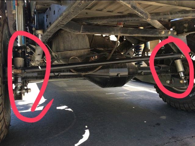

    What are things circled? I thought bumps at first but you have them.

    Right on, so welded gussets on without spacers in and wedging bumps into bump cans that are in the wrong spot and need to be moved.. seems legit.
    Kidding, you'll get it, will be a fun truck with that kit and links.
    I'd just get those outer misalignments turned down on a lathe and call it a day.

    They are to hold the axle from twisting since there are no upper links.

    Got it. Thanks

    Yep, they are 2.5" air shocks with a shit load of valving and 550psi of nitrogen to set the pinion on the axle. they also help with sway.

    That's a good set up Landon. My buddy has the same set up on his truck. It helped with sway also like you said
