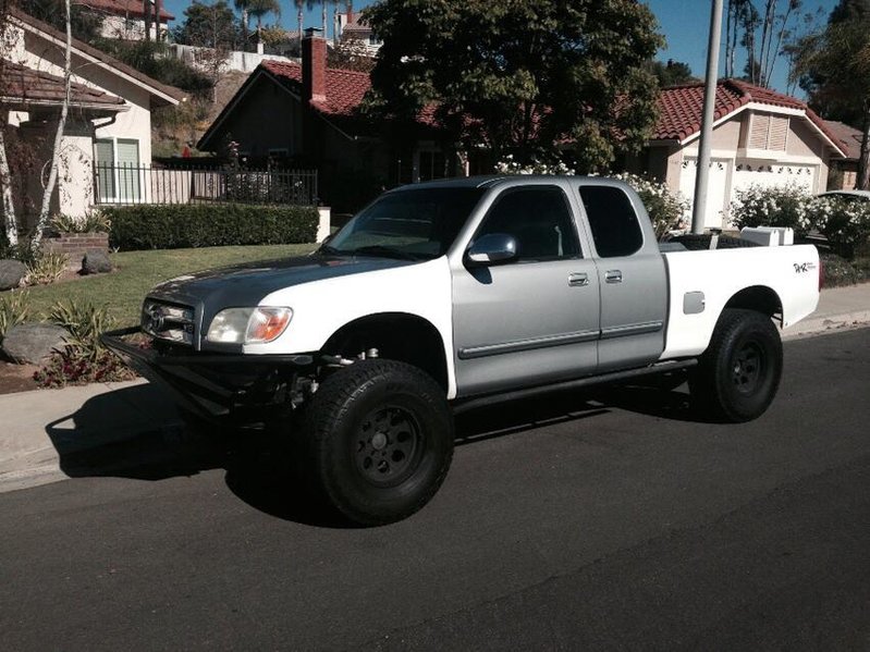

    Picked up a new truck today....
  20. Nov 9, 2014 at 6:34 AM
    06HAOLE
    06HAOLE Well-Known Member
    Jan 4, 2008
    #4102
    3,190
    Fort Worth, TX
    2019 Ford Raptor
    Does the previous owner live in San Marcos? I think I've seen it around. Cool truck and was on my list when I was looking for an older one myself.
