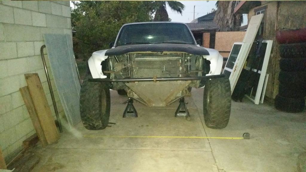

    http://www.tacomaworld.com/forum/2nd-gen-builds/227832-my-never-end-build.html
    He thinks its a skateboard lol

    Trying to get the calipers on the rotors but they don't open enough to fit, anyone know how to get them opened?

    pry them slowly with a pry par

    Open the bleeder if needed and use a pry bar

    Do you have access to a c clamp? I have a tool for this but a clamp doesthe same thing take off the pads and compress the pistons then re install the pads and put them on.
