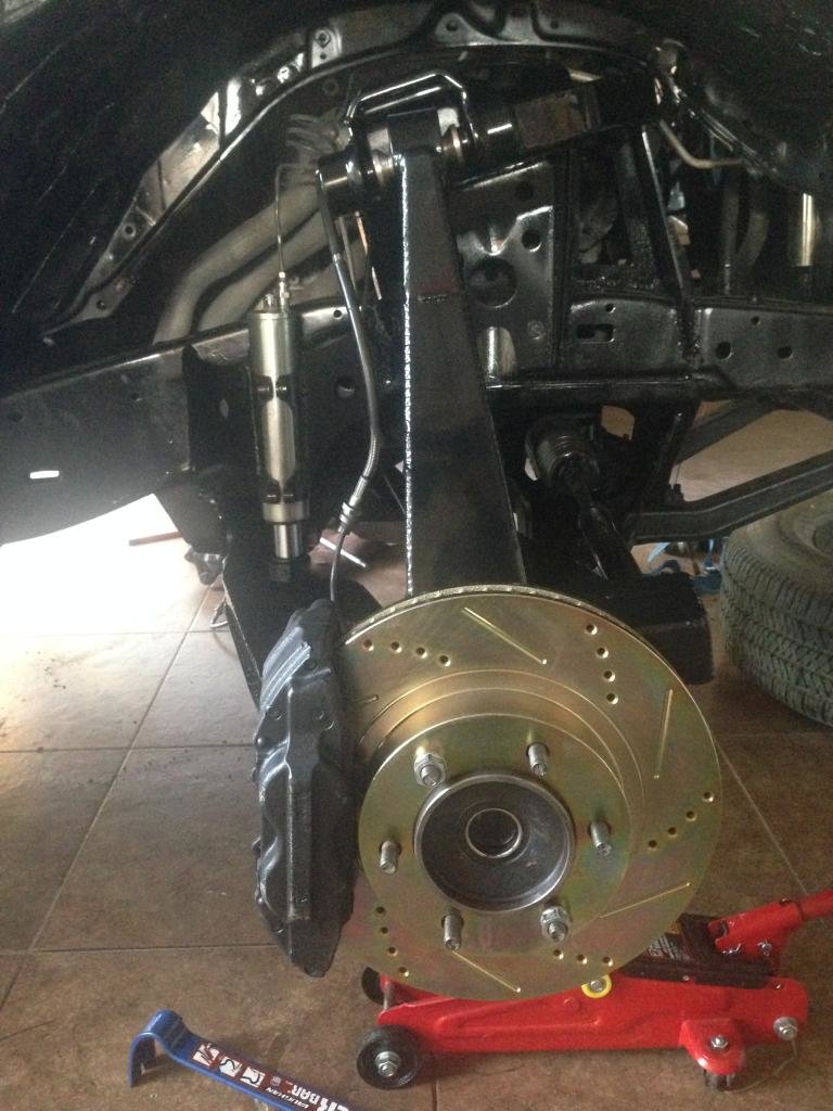

    You can also pop the pads out and put a C clamp on the Pistons to compress them all the way in, then put the pads back in. After you push the brake pedal a few times they will even back out.

    pry em apart with a pry bar just be gentle as to not tear up the pads to much, do you already have the brake lines re connected? never had to do it on my truck so don't know how hard it is on big calipers. I'm sure someone else will chime in, but iv done it hundreds off times when i worked at a bike shop and it was a pain in the ass because the calipers are the size of a fucking golf ball on those things.

    I would not use a pry bar have seen people fuck up pads doing it that way. Just a fair warning

    Take the pads out and press the pistons in before putting pads in.

    Thanks guys :thumbsup:
    took pads out, opened bleeder and used the pry bar to push the pistons in ;)

    Pry with the old pads. Works every time and no fucks given if the pads shit the bed.
