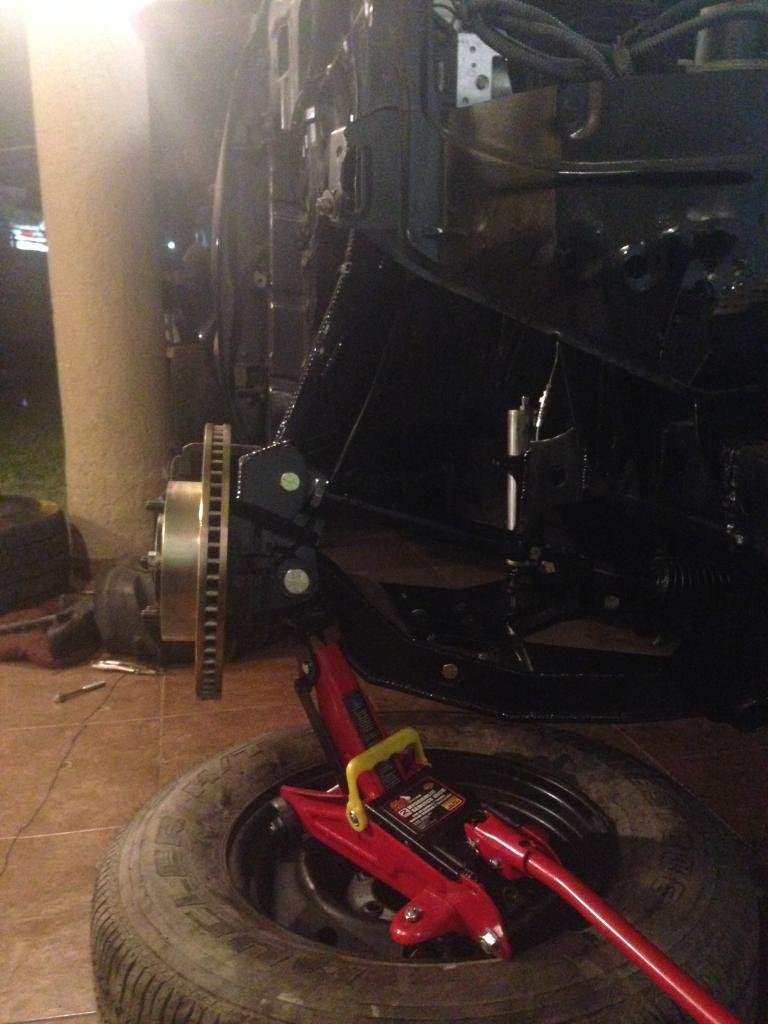

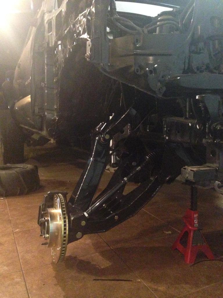

    Wouldn't you get a lot more travel if you hiemed the inner tie rods? You plan on bumping off the spindle right?
  4. Nov 9, 2014 at 10:04 PM
    JordanSmith127
    JordanSmith127 Jordemo805@yahoo.com
    Sep 27, 2010
    #43908
    1,918
    JORDAN
    SAN LUIS OBISPO & MARIN
    2017 DCSB 4X4 TRD SPORT
    ICON / LSK
    mine are hiemed but not sure if its giving me more travel, anthony is pulling full travel and his are not hiemed, i wasn't pulling full travel with mine tho cuz i still had the inner fender well so i was strapped around 16-17" instead of 19"

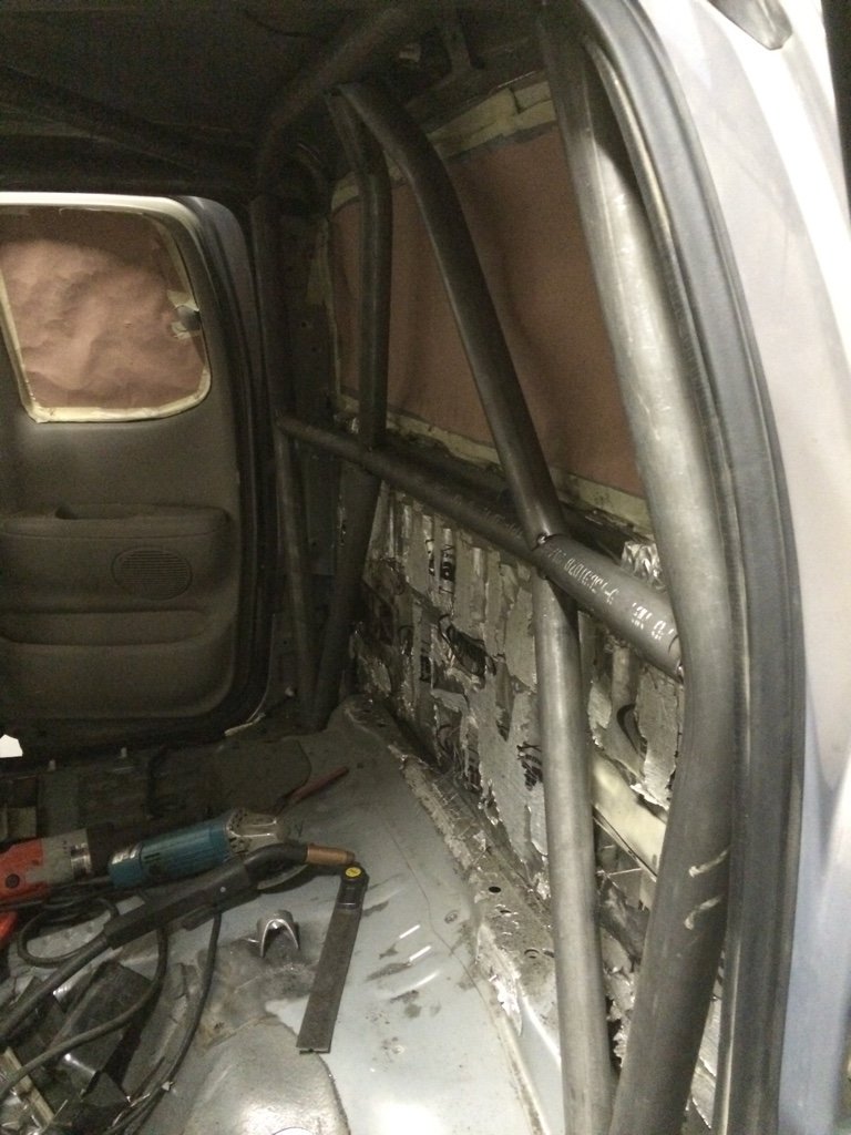

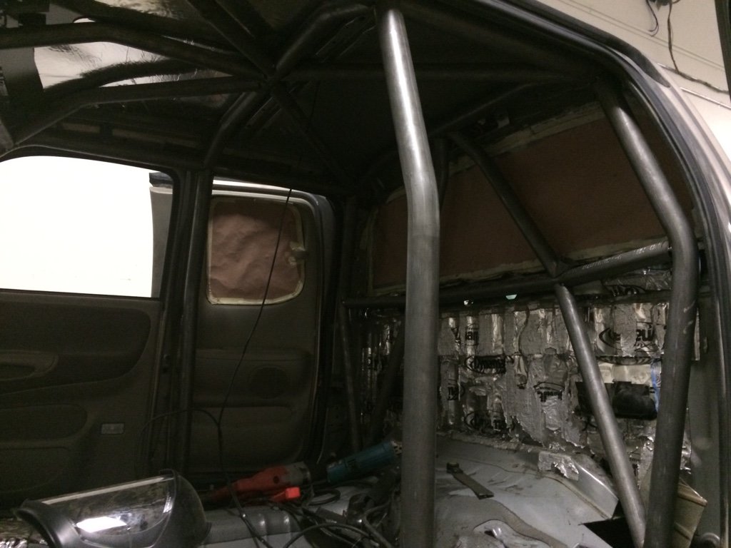

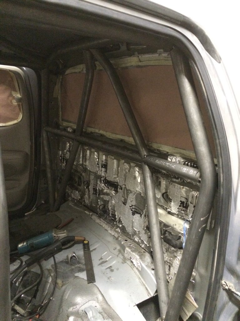

    Got a ton done on my cage this weekend

    Dat cage life doe. MMMM. Looks good.

    It would be easier if I wasn't trying to fit a full size 3rd seat so much extra work to make as much clearance as possible.

    Looks great Landon.
    How are you going to fully weld it?

    All the pillars are just tacked in, and I cut extra big holes in the floor for the a and b pillars. Basically I'll lower it tilting forward.

    Can't wait to see the finished product. Looks like some tight clearances.

    Oh interesting. Always wondered about that.

    Thanks man, only reason I left the c pillars so far from the rear on the sides is because the rear window is held in with bolts. So I want to be able to replace the window if it ever breaks

    And I had to leave the cross bar at the top off the rear a bit because I want to keep the 3rd brake light and bed lights. Hence all the bends to keep the 3rd seat as tight to the cab as possible

    The plans are to bump the UCA, how is setup right now Im getting 17'' of travel bumping LCA. When I bump the UCA I'll try to get the most travel out of it.
    What is needed to go full hiem?

    Oh and the real fun has been using 2" for all the main tubes in the cage.
