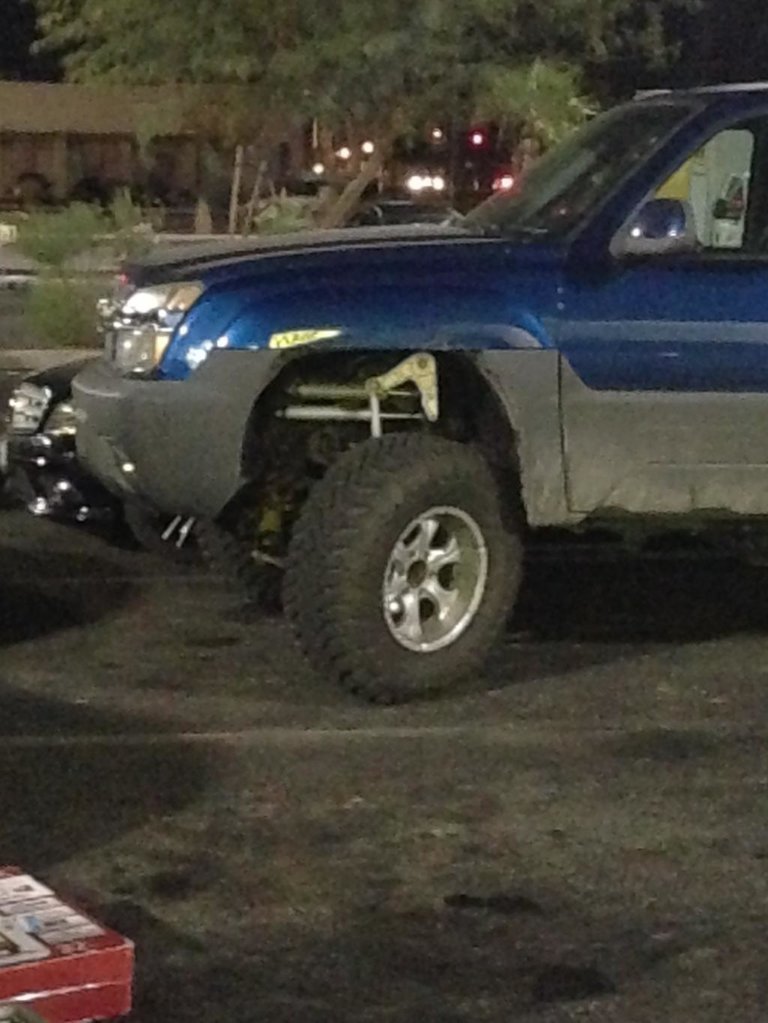

    Ha
    That snail trail left a permanent stain!

    LOL
    want to see that setup too!

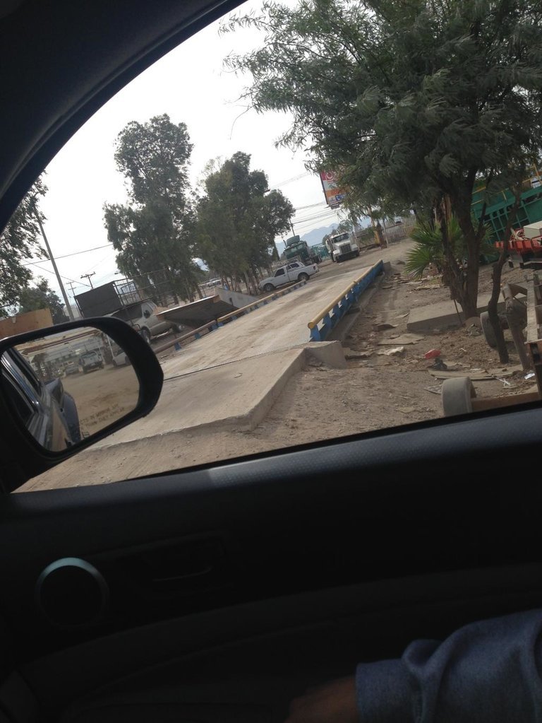

    Got my truck to the scale and it weights 5260 lbs! He's a fat bastard lol. Thats with me (190~ lbs 6ft) and two friends (around 140 lbs each) skinny guys haha. oh and 1 matching spare.

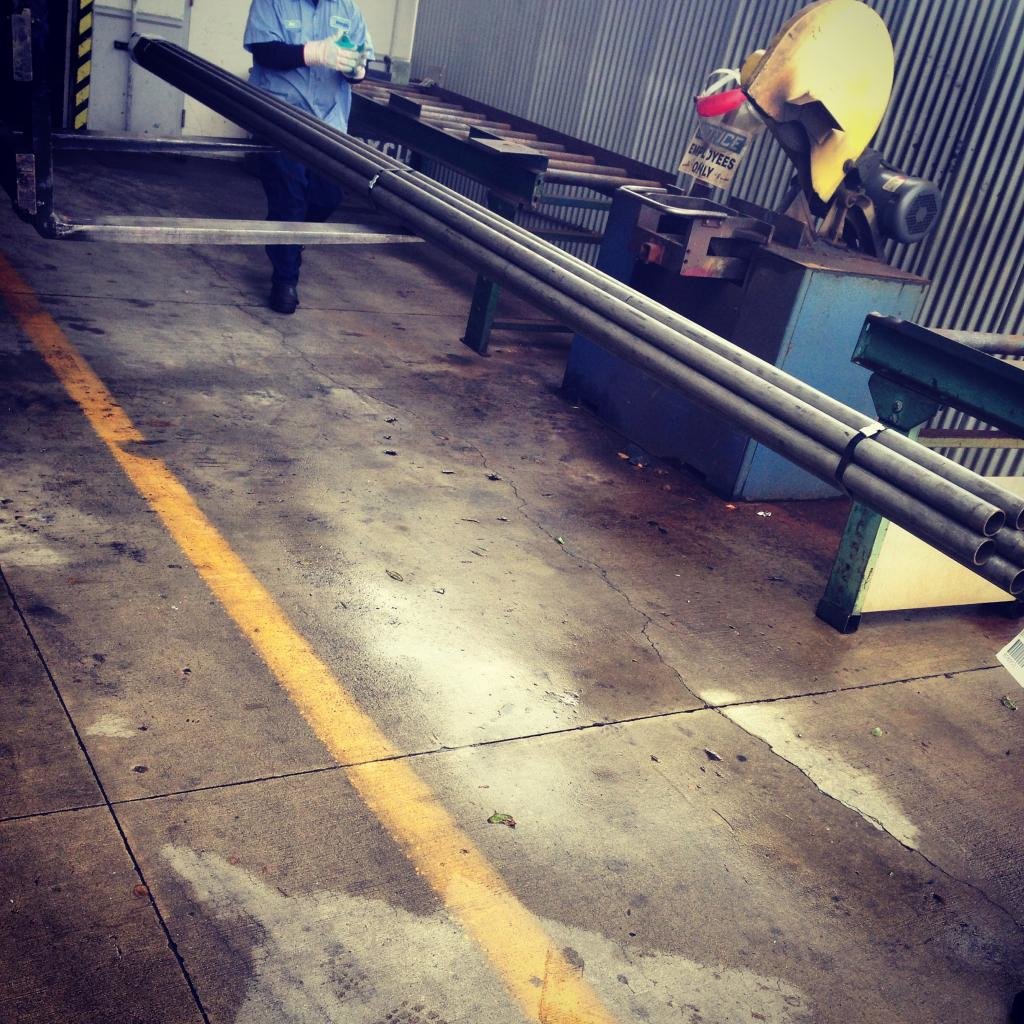

    Got a quote for DOM tube from tube service co. but it says ''round carbon steel tube DOM-SRA'' Is it what I need?

    SRA=stress relieved and annealled. There should be a 4 digit number there too, and it's probably 1018 or 1026. If it is, then that's what you are looking for and is "score legal". 4130 is the good stuff, but it's cost prohibitive at our level and technically requires a huge oven to stress relieve, although most ignore that.

    its 1020

    Sweet. If the price is pretty close, call and ask if it's USA DOM (it will be marked on the metal) or if it's from India. The USA stuff is almost twice as strong. The foreign foundries use a lot less carbon than we do or something, and you can tell when you put it in a bender. It bends like poop pipe. I'm not saying it's bad or unsafe, just that USA metal is significantly stronger for about the same coin. You can find it at Patton's in Hesperia pretty often.

    I'll look for USA in the tube tomorrow pretty sure its usa made, she didn't told me it was imported or something.

    99% of steel is from India, it's all put to the same tests per batch. Don't sweat it
    Oh and id recommend only doing the main tubes with 2"

    So its the same strength? What tubes need to be 2'' to be score legal?

    Only the pillars and main cross tubes have to be 2"

    Got 180ft .120 of DOM tube us made for the roll cage, engine cage and bumper

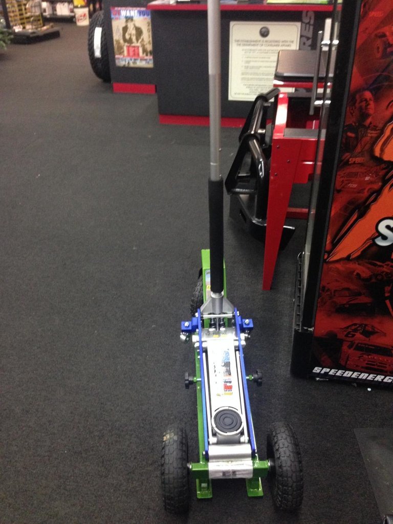

    Also took a look at a TT at ORW
    Saw this sick jack
    Avalanche set up haha
