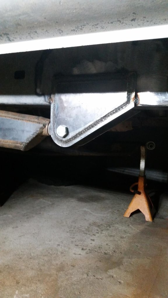

    got a question. i have a big sheet of 1/8 plate. i feel like its too thin for tabs for seats in a caged SR1 rhino? the tabs would be like 4 inches tall. i thought about throwing a gusset on each one?
    i already have a ton of that plate so i dont really want to go and buy thicker, but i dont mind doing it if i need to.
    thanks.

    That's tall to use 1/8. You could do an overlay if you don't want to buy more plate.
    For reference

    Make a second plate a little smaller around and with a large hole in the middle, and weld it on top of the first one... or make some perpendicular gussets/ribs and weld those on?
    or buy 1/4" haha
    edit: jeff beat me to it

    okay if i can find a plasma cutter or something ill do that. if i have to stick with a angle grinder ill just get thicker plate so i dont spend decades cutting tabs.
    stupid tabs take forever with a angle grinder.
    thanks guys. i assumed it wasnt strong enough but my friend said it was so i wanted to get your guys's imput.

    If it was a shorter tab, I'd say go for it, but 4" is tall. Seat might fold over those tabs.
