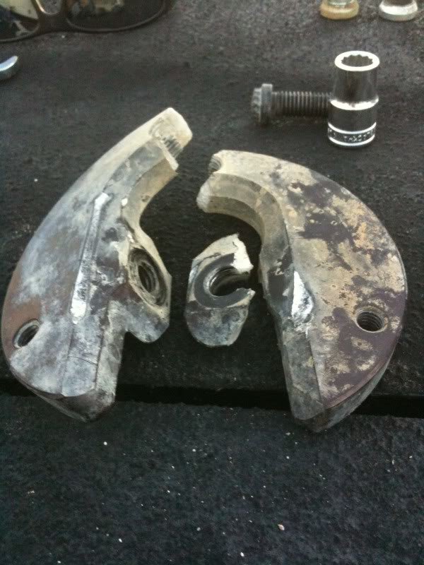

    So that was caused by a longer spring, with less preload, bottoming out?
    Just trying to understand so I don't repeat the same mistake.

    Assuming coils binded before hitting the bumpstops. Sent the impact up to the coilbucket.

    Yes. I looked at Eibach's chart and on paper they should work. 18x3" 700 lb rate coils should collapse 8.91" before turning into blocks. There was zero preload on them. The charts are not accurate. You get about 7.65" inches of travel out of them, then the coils touch and boom. Measure the coils with a micrometer, starting from bottom to top and add those measurements together to get block height, don't trust the charts. 650's the same dimension clear on an 8" shock, go figure.
