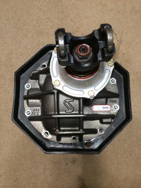

    so it taps in from the inside of the flange? The seal popped forward and tapped right in to the outside of the flange.
  12. Jan 1, 2015 at 11:45 PM
    tostidos
    tostidos Well-Known Member
    Dec 24, 2010
    #48149
    4,755
    Apple Valley, CA
    07 LT 6spd
    ImageUploadedByTapatalk1420184705.029499.jpg this is the only pic I have of it.
  13. Jan 1, 2015 at 11:48 PM
    thekernel114
    thekernel114 Well-Known Member
    Sep 30, 2011
    #64427
    1,041
    Chilliwack, B.C.
    07 tacoma 4x4
    allpro long travel, shackle flip with ome dakars, cruisin offroad bumpers and sliders, 4.88 gears with arb's front and rear, budbuilt skids.
    The yoke has to come off to change the seal. If you have a solid pinion spacer (not sure if ford 9's even have pinion spacers) its as easy as impacting the big nut off, removing the yoke, replacing the seal, putting the yoke back on and torquing to spec again.

    Ooo. Not a Toyota diff. Never mind. Haha
