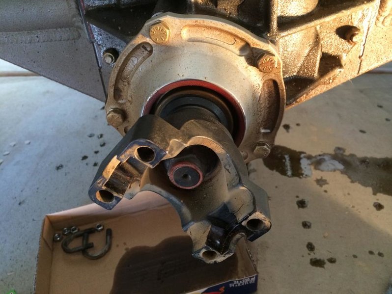

    picked up a seal today, going to mess with it in a few. After looking at it I think I going to be able to get away with pulling the yoke and pulling the ol one and tapping in the new. Might do a small bit of RTV for peace of mind. If you guys are interested I will post pics. I know these type of things dont make it on here much.

    Chris where is your rear end from?? I saw your 3rd member but wondering about the rest

    Bought it straight from strange. Brand new.

    The rest of the rear end engage built.

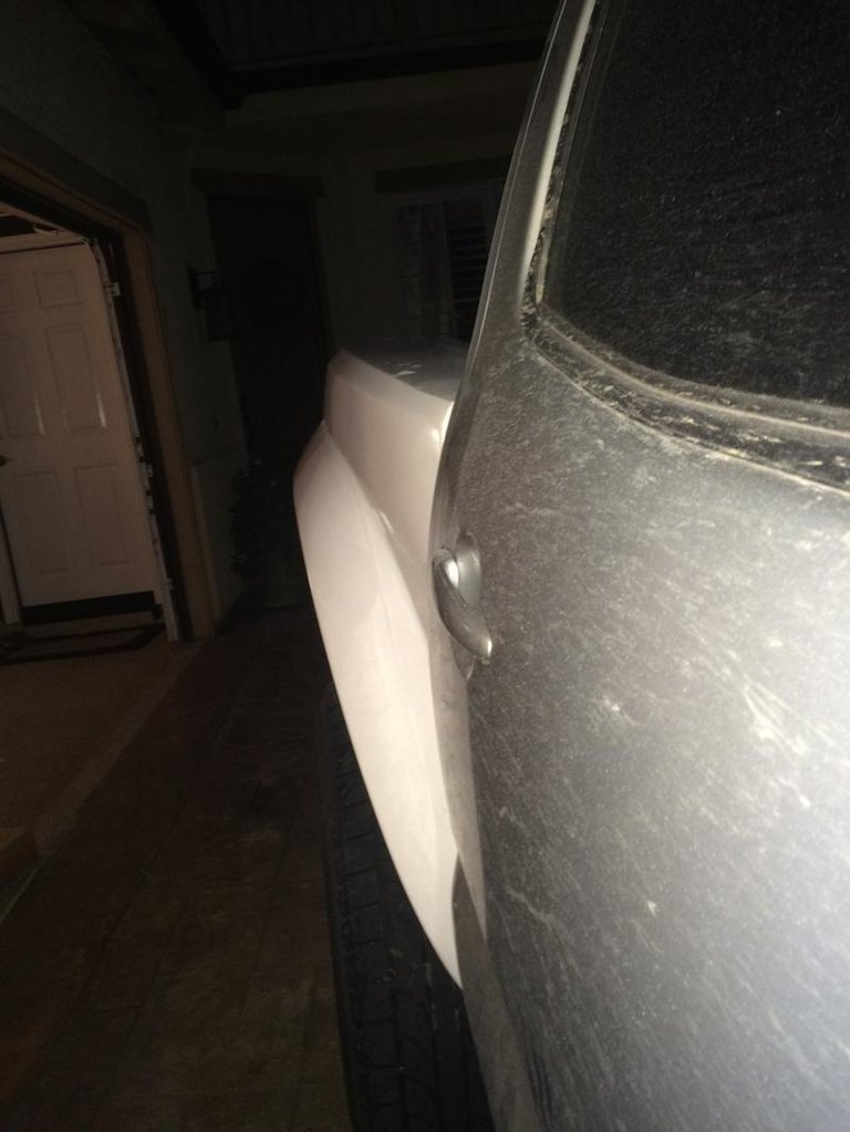

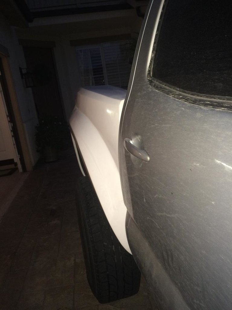

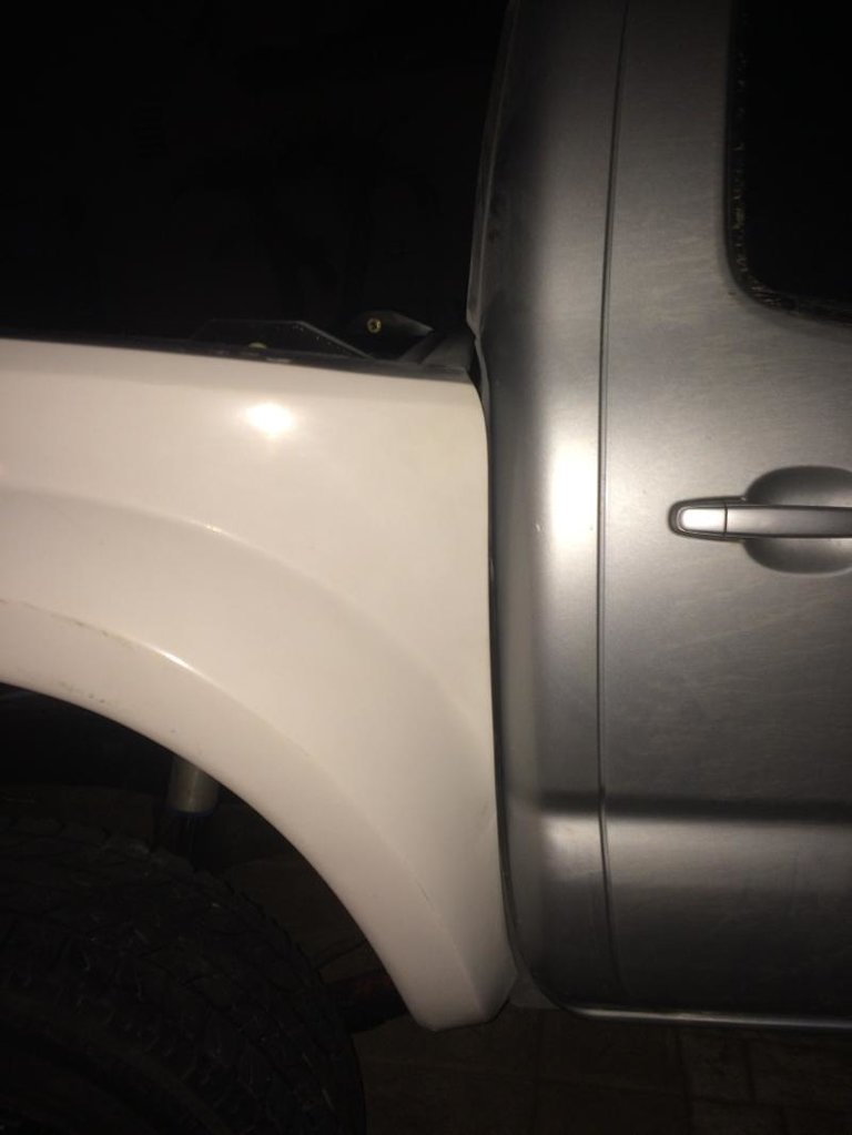

    First time messing with glass bedsides, wanted to see what you guys think of the body lines, etc, according to my shitty pics. Not bolted in yet all the way and the supports arent in but the majority if not all the trimming is done on this side.

    not bad. id advise to keep them as far back from the cab as possible to prevent the tapping/banging from cab wobble in shutter bumps.

    Thanks! Ill do that, the pics make it look closer to the cab than they are theres a decent amount of space left. I took the dremel and ground down a little bit of the edge on the composite bed.

    You have to find out if you have a solid spacer or a crush sleeve in there first. If you have a crush sleep do not take that Yoke off, you will mess up the adjustment on the gears and have to redo everything

    I'm really surprised how hard it is to find info out about differentials. Doesn't help that strange is closed until Monday.

    take the yoke off, if there's a solid spacer behind it on the shaft then you can just re-assemble everything and torque to spec, if it has a crush sleeve then you will need someone who knows what they're doing to help you out. I don't have a pic of a crush sleeve but you can find it on google

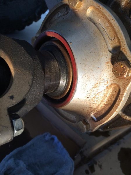

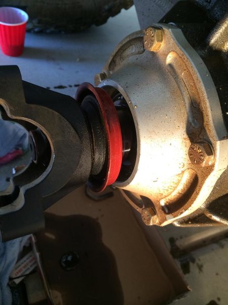

    ImageUploadedByTapatalk1420323400.451845.jpg before driveshaft removal
    Driveshaft removal
    how I found the seal
