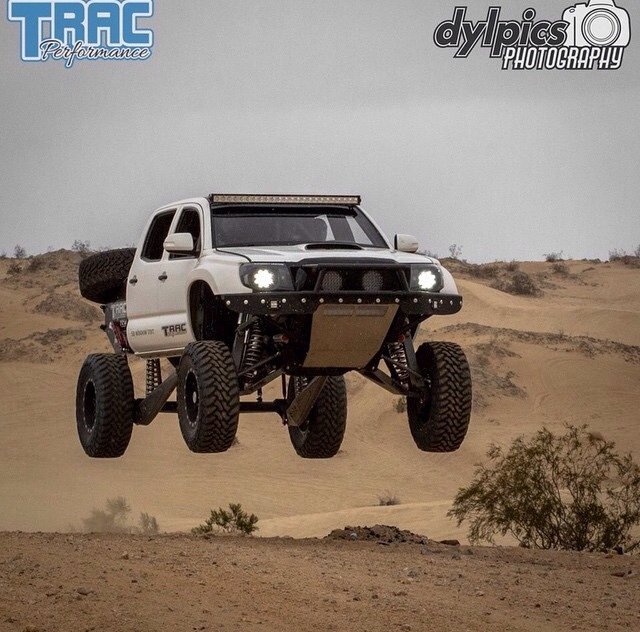

    Wow nice shot! And the truck looks sick!! Really need to make it out again and get a few photos. And play in the dirt with you guys, guess I need to start saving some pennies for s front kit. MT up front is nice but would love to update the kit to keep up with the rear. Course than I'll want links to replace the rear kit and so on and so on...
    But back to the point glad you got some good photos of the new build, looks sick.

    Is there a video of this jump?

    Just seen the video.
    Very smooth

    Wow, very impressed with the quality of TRAC's work.
