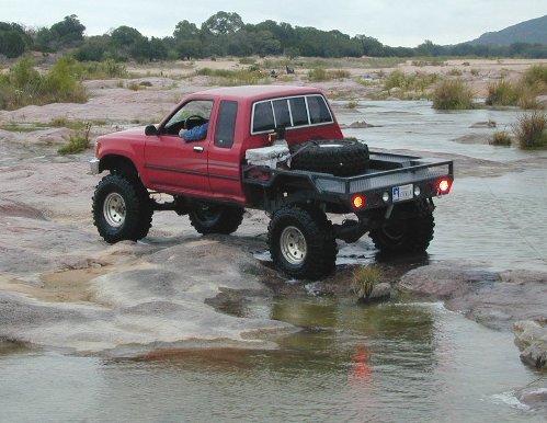

    So my bed is pretty much destroyed after superstition...I was thinking of ditching the bed and doing like 3/16 or 1/8 ? Aluminum plating and making a bed so it's not just open. Or should I just swap in a new bed?
    Thoughts/ ideas ?

    I say redneck style
    41124d1038542272-official-toyota-flatbed_6f2449156acc47e33e9da1b1e64ca3fd02bf371d.jpg

    thats gon be a heavy bitch
    don't trip man your bed isn't anything a 5lb sledge and some redneck ingenuity can't fix
    i'll be back home in a week and we'll jam on it... in the mean time track down a stock tailgate!

    going to be heavy. and expensive.
    a sheet of 1/8 is heavy as fuck.
    but will be sweet....

    you can get metal sheets that are the same shape as the bed (kind of corrugated) and make a bed out of that... or we can just weld the crack together and hammer slam the bed back into shape, then fry up a sweet new bumper. maybe chop the bedcage and move the shocks outside the frame like you were talking about wanting to do as well.. i think you'll regret ditching the bed completely and building a whole new one will be tricky to balance weight and strength without pre-formed metal
