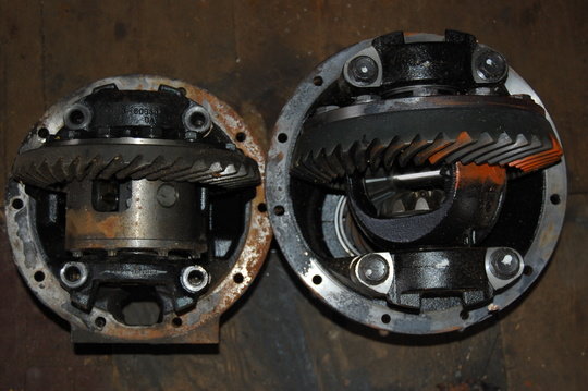

    Tundra 10.5" axle for sure. I'm $4700 into my 9.5". Going with a comparable 9" would have been about a grand more, and may or may not be as strong. I don't know why, but I like the idea of having an "all toyota" truck, even though half that shit is 300M and 'moly from who knows where. :rolleyes:

    Yeah I guess it would be. The only thing I can find says 66" WMS to WMS, but that can't be right, as 2nd gen tacos are 65". (EDIT: The old tundra/t100 is 66")
    10.5" next to a 9.5". They are about the same strength as a dana 80.
