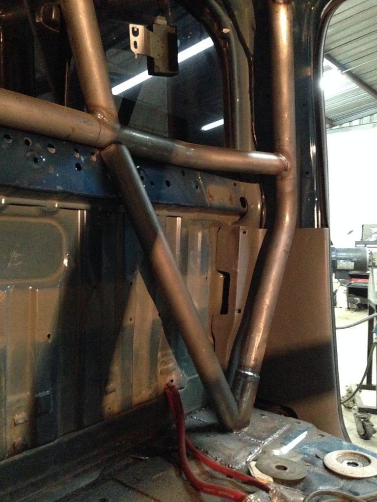

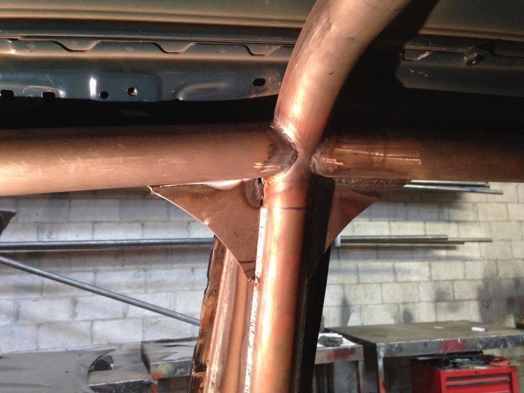

  18. Jan 28, 2015 at 5:39 PM
    tacomonazul
    tacomonazul Well-Known Member
    Mar 4, 2012
    #74163
    3,384
    Luis
    SOCAL
    07 DCSB LT/4LINK
    http://www.tacomaworld.com/forum/2nd-gen-builds/227832-my-never-end-build.html
    Got some gussets in, where else do I need?
  19. Jan 28, 2015 at 5:51 PM
    jberry813
    Jan 21, 2011
    #49636
    28,484
    Jason
    Lake Tahoe
    2012 DCSB Sport
    ...too much shit to list.
    Hard to tell from the picture, but what thickness material did you use for the gussets? If you're trying to get score tagged they need to be 3"x3"x.125" (or you can use tube gussets).
    As for "where" to put gussets. They need to be on all main intersections on the main cage including diagonal and rear down braces, and "anywhere single weld fractures can affect driver’s safety."
  20. Jan 28, 2015 at 6:06 PM
    tacomonazul
    Mar 4, 2012
    #74163
    3,384
    Luis
    SOCAL
    07 DCSB LT/4LINK
    Used 1/8'', gussets are 4''x4''x.125''. So basically need gussets on all tube connections?
