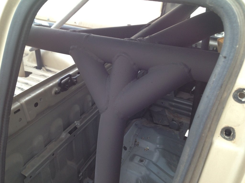

    You should gusset as much of the cab cage as practically possible. Tube gussets are best.
    It's cool and all to be able tell Tacomaworld that you're SCORE tagged, but it really comes down to yours and your passengers' safety. So you should be surpassing their requirements.

    Yeah thats what really matters, what tube would you recommend to use instead of 1/8'' chromoly plates?

    i think they mean using tube as a gusset like so 685c60673427b20b4a22cc62a8176cf4_f93c0df06cc1985630e8e47f10029e6f61dd5da8.jpg
    so whatever tube you're using for the cage

    Same wall thickness of your cage, so presumably .120 wall. Doesn't need to be 2" like the main tubes. Can use 1.75".
    Like so
