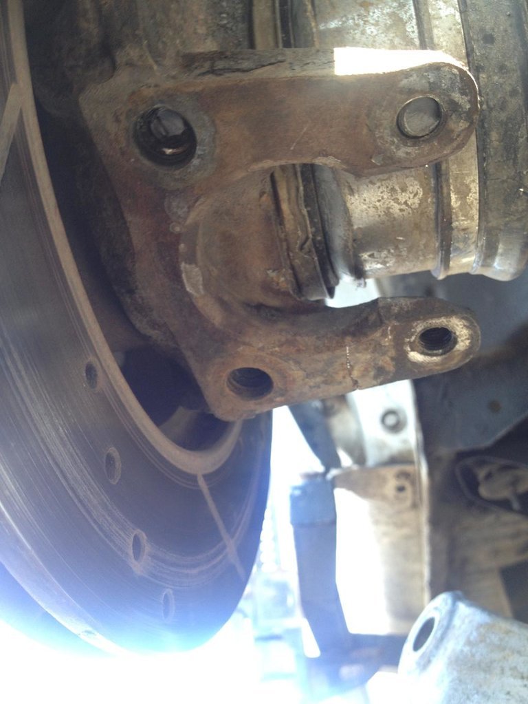

    Could you be side loading the Uniball Bolt against the cup at droop? that would move all the stress to those four bolts. or it could cause the upper spindle mount to break off depending which one side loads first. resolve it by adjusting or installing limit straps and bump stops.
    yeah you might lose an inch of bragging travel but it will keep you on all four :)

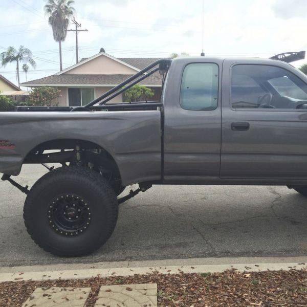

    Looking at this from a computer instead of my phone. Those four bolts holding the spindle to the LBJ/uniball are not the largest of bolts by any means. Repeated removal/installation certainly doesn't help. And the big thing I've found, is unless you lock the steering wheel (pull the key out of the ignition and turn the steering wheel till it locks), you will over-torque the bolts just due to the rack being able to float (speaking from experience here...see below). This in turn will stretch and or stress the bolt ultimately fatiguing it.

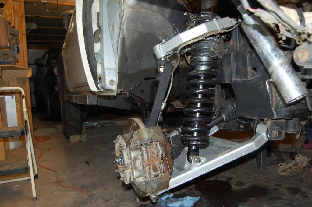

    Still curious as to how you did a horizontal uniball adapter (well, i'm assuming horizontal based off the big nut and bolt) hanging off the bottom of the LCA.
    As an aside, it's always nice to see people trying to build their own kits. But I have a couple questions if you don't mind. Not trying to be a smart ass or undermind your work at all, just curious.
    1) Why square tube? Again I'm just going off the one picture, but it looks like you have heim uppers with a round bung, that goes into square tube.
    2) Are the joints on the square tube miter joints? If so...why did you blend the welds?
    3) Gussets? I don't see the LCA pivots wrapped to the square tube. Nor do I see any gussets that tie the upper uniball to the two side tubes. It looks like the side tubes are just welded to the uniball cup. That pivot takes a lot of load when you're beating on the truck. Simple piece of plate that ties all three pieces together does wonders for strength.
    4) What length coilover is in there? I'm guessing a 12" because it looks like you've got a ton of open threads at the top going up into the fender aprons. And if it is a 12...why such a short tender spring?
    5) How much CV plungs did you measure when you were designing the kit. From my experience, 14" of wheel travel is about all you're going to be able to get out of a 4wd kit.

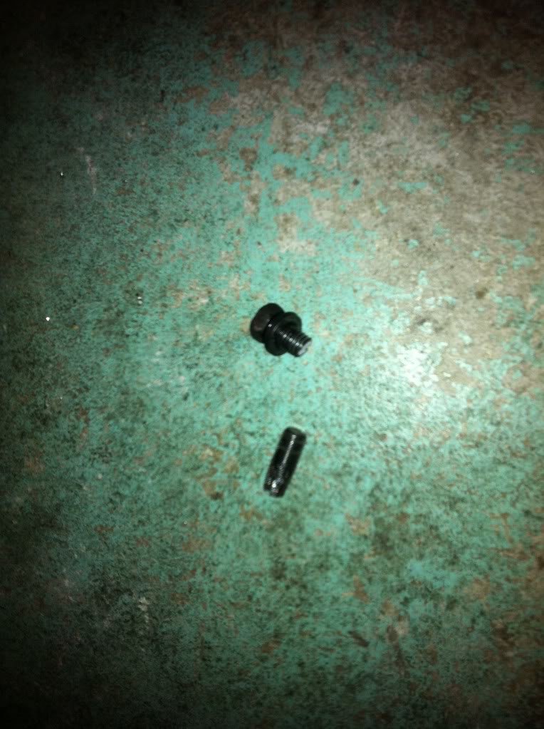

    Oh yeah...obligatory broken bolt. Using a torque wrench without locked steering wheel.

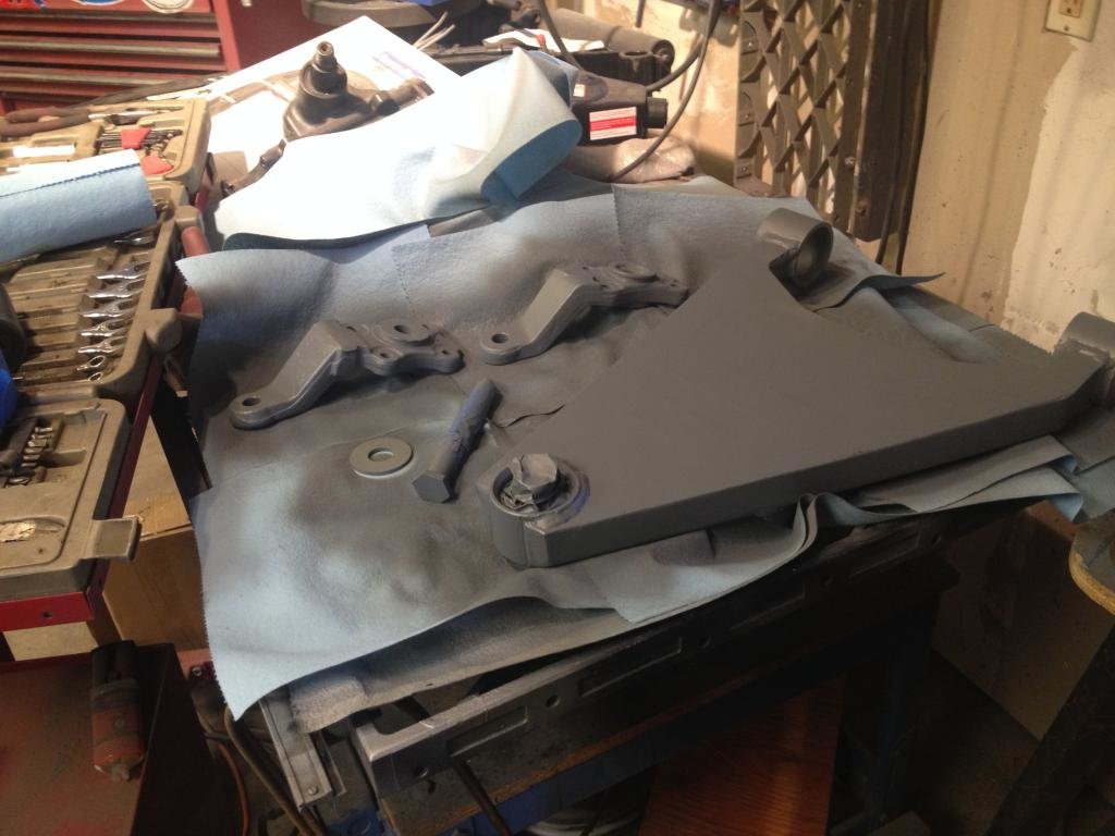

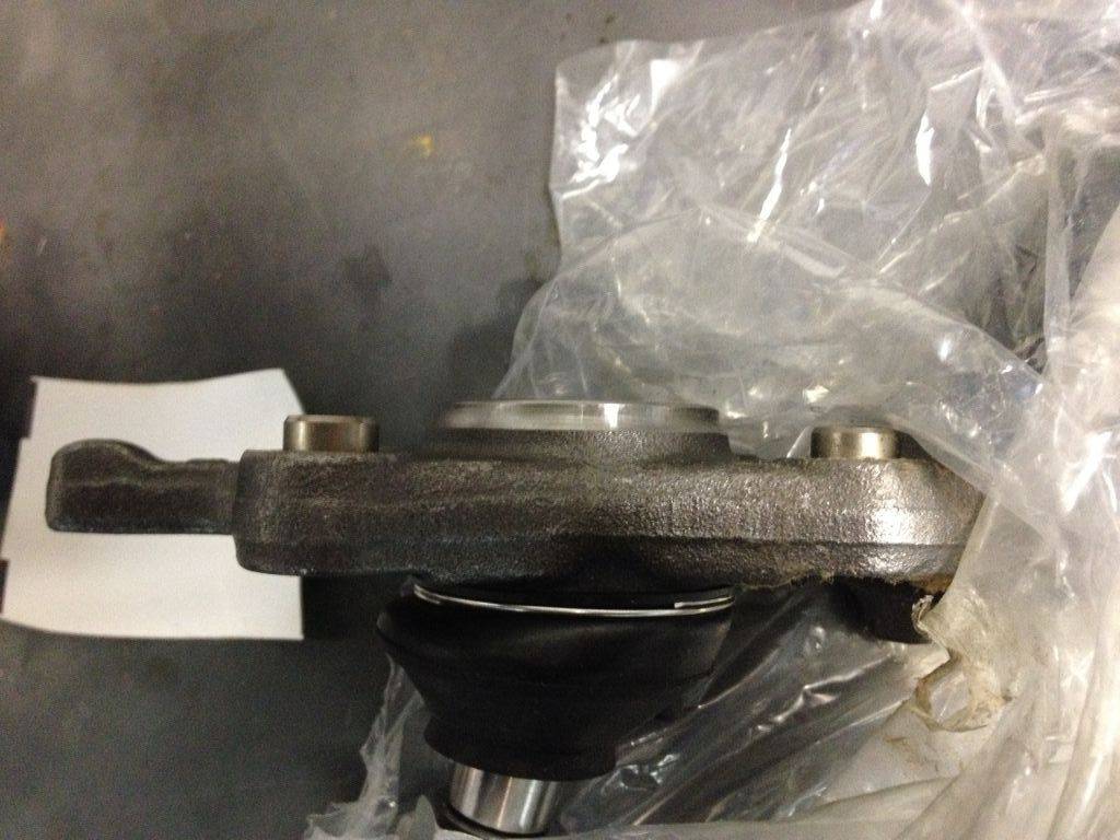

    Something else comes to mind. But this would completely depend on how the lower uniball adapter was designed to mate to a stock spindle. From a factory LBJ/Spindle perspective, the LBJ has little sleeves to center the ball joint correctly into the spindle on the outside two mounting bolts (two bolts closest to the hub face...see picture below). It does not rely on just the 4 bolts.
    So if the adapter was built with just the bolts in mind and not the countersunk sleeves that go into the spindle, there would be 3/16 of an inch where there was no contact of the LBJ adapter to the spindle. Meaning just 3/16" of loose threads right in the middle of the bolt that would allow for it to sheer easier. And judging by the original picture...that's about how far up where the bolts sheered in the spindle on the outside 2 bolts.
    Stock LBJ showing sleeves:

    No, it didn't seem necessary based on my FEA.
    Someone else has suggested this, and that certainly makes sense. Like you said, I don't yet have limit straps and I don't have much down travel from ride height.
    That's a good point you make on the repeated removal, my dad said something similar how you're supposed to replace bolts on high cost parts every time since just torquing them once removes their usability again--and obviously these were 14 year old bolts.
    For the LCA interface, I bought two LBJ and then if you grind down the top circular part (opposite the joint stud) on the crimped lip, then the backing cover will pop off and the actual joint will pull out. I then made a 1" tall steel spacer that was tight against the hole where the joint was and dropped it in, and then filled it in with weld. From there I just drilled out the weld/spacer to the size bolt I needed (3/4"). So the bolt drops through the LBJ piece, which bolts to the spindle like usual, and the 3/4" bolt then goes through the uniball on the LCA.
    C00E3D7F-0D84-4364-B525-D65EFAEAC4B4_zps_a81d36efe01f1daf99d1b1b67c609fa62398dc59.jpg
    The more questions the better, if I over looked something then it's better to find out at the keyboard than on the interstate or trail.
    1. The main reasoning was for simplicity. My buddy and I planned to LT at the same time, but to do so we had to first get a garage and then buy the tools we needed. It was much easier to just use square tubing where everything was a vertical cut versus getting fancy with bending round tube and notching it and the required tools we'd have to buy, versus just getting a compound miter saw. Like you said, that provided its own issues. We bought most of our parts off of Poly, but even from Ballistic and other places I couldn't find a corresponding square bung so we ultimately had to use the round bung and just fill it with weld over multiple passes. The square tubing is 3/16 wall so we could get a lot of penetration on it as well as the round bung. There only seemed to be square bungs for really large tubing, like 1.5" ID or bigger which would be way too big for our design so we just compromised and made the round bung work.
    2. Yes, the upper arm are all miter joints. Not sure what you mean by blend the weld?
    3. It wouldn't hurt, but I didn't see any need based on the FEA and weld analysis. Like you said, a lot of kits have gussets and I've seen a few that run a strap around the uniball cup. I think that'd be smart to do in the future on a second iteration, but for now I'll see how it works and keep inspecting everything.
    4. It's a 10" coilover, I mainly wanted to be able to run dual rate and I was originally planning for 16-17" of travel. My tender is way wrong which is why it's threaded down so much, the tender is essentially fully compressed with the weight of the truck on it.
    5. Not sure what you mean by CV plung. After I bought the CVs I did a rough cycling of them to see how much travel I could pull, it was a very rudimentary estimate but it seemed like I could get 19" of travel--that was playing with it by hand. Right now I'm getting 14" of useable travel, and the CV angle is more extreme on droop (which is limited by the CV) than it is at full bump which is limited by the UCA uniball. I want to run a horizontal uniball UCA this summer to try and pull more travel, I think I can realistically get 16" of travel with a horizontal upper (horizontal bolt). I think my geometry is different than other kits though because I'm pulling way more up travel but less down travel. I have 4" of droop from ride height, but 10" of up travel. The main difference mine has versus a bolt on kit, is that my frame/stock bump stop areas are chopped so I can get more up travel which is why I'm certain I can get over 14" since I can utilize all the additional up travel that's usually untapped. Though again, somehow I have a ton of up travel but only the same total travel as a bolt on.
    I thought I someone ask about the frame mounts for the LCA, they are the stock mounting locations but plated with 3/16" and no longer cammed. All adjustment is through the UCA heims.
    I have no issue with people giving advice or insight, this is my first stab into suspension design and I still have tons to learn obviously. My annoyances of the first few posts were because, regardless if the bolts were loose, you can still see the ends of them threaded all the way into the spindle so they should of still been reacting loads without issue.
    I think I will also redesign the LBJ/knuckle bolts. I don't know what loading made them fail, but I know what loading I designed the UCA, LCA, and steering linkage. I'll just make sure the four bolts are stronger than everything else, so in a worse case scenario the A-arms and steering will yield and absorb all the energy before the spindle shears from the suspension, and since the spindle has redundant mounts (LCA/UCA) then if one A-arm fails the tire will still stay attached to the truck. Like you said jberry, the LBJ bolts are way smaller than anything else on the suspension right now.

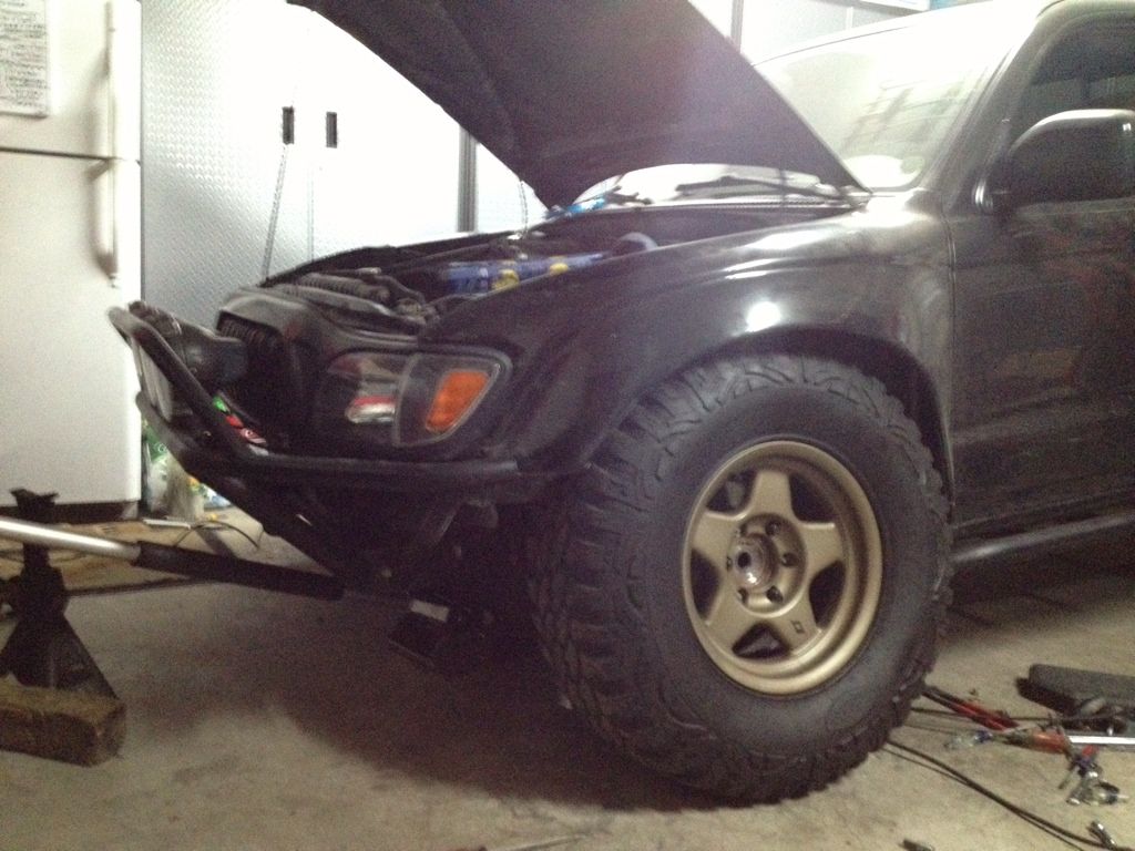

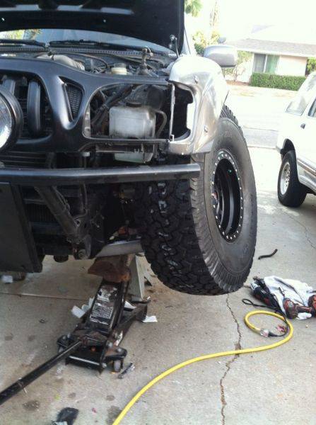

    I haven't had a chance to remove the coilovers and cycle the suspension to check for bump steer, however I had bad "droop steer". When the suspension would droop at all (even from just accelerating a little) the tires would toe in and start to push against each other and you could feel the whole front end rise up then. I had to put a spacer on the steering knuckle to stop that, which I plan to reinforce and double shear in the future. After doing that I don't know what my bump steer is like. When I've had the suspension compresses a lot offroad its felt fine and works fine, but I don't know exactly how the geometry is changing. That's my biggest fear is having really bad bump steer I can't fix.

    Bump steeerrr :p

    Dat bump steer though:eek:
    Yes I know your wheel is just turned (I hope anyway!)

    Much bump steer
