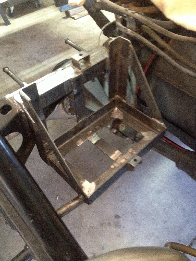

    That truss sure is gonna do alot of good:rolleyes:
  11. Feb 20, 2015 at 5:58 PM
    jeffz0rz
    jeffz0rz Well-Known Member
    Dec 9, 2009
    #27296
    3,958
    san diego
    1996 tacoma 4cyl, 5spd
    Yeah it will. It'll keep the inside 40% of the housing from bending. The outside? Eh, that's not that important...

    Those tubes are 3.5" 3/8" thick.... A truss is really only needed for racing.

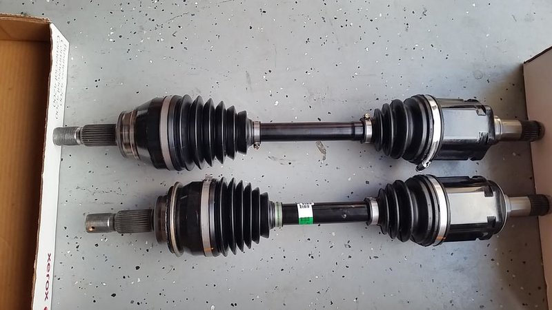

    Tell tale for OEM axles is the green/white label thing on the shaft. (At least for 2nd gens)
  20. Feb 21, 2015 at 8:50 AM
    kevin96
    kevin96 Well-Known Member
    Oct 11, 2013
    #114300
    82
    Thank you very much! The axle they didn't test out was the one that had the green sticker so hopefully everything ends up alright. This has been the biggest pain in the ass.
