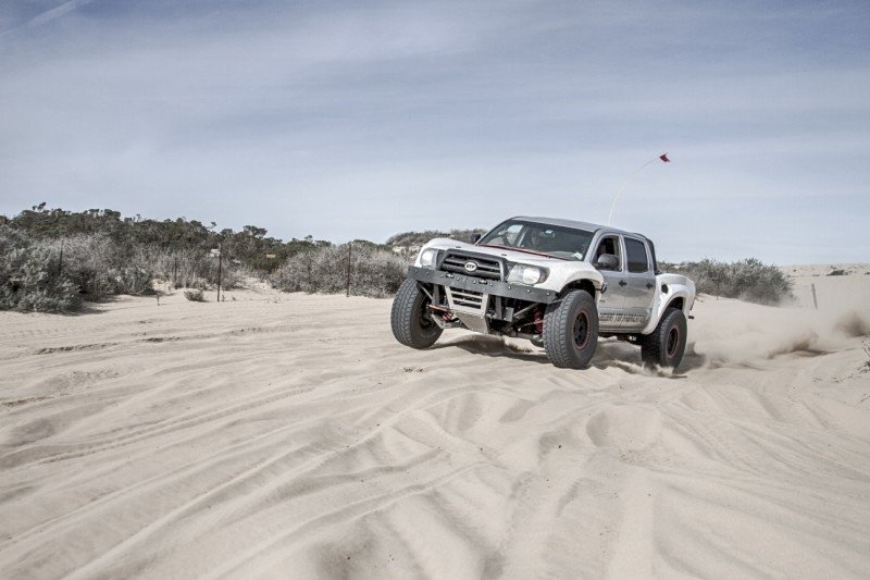

    The Tundy rack has the same dimensions?
    That's the plan ;)
    Thanks a lot Kris. I'm glad people that actually have race experience can chime in. I spent months doing research on proper suspension geometry and looked at what people were doing wrong and what could use improvement. My stock rack still works great even with 37s and offroading at least once a week.

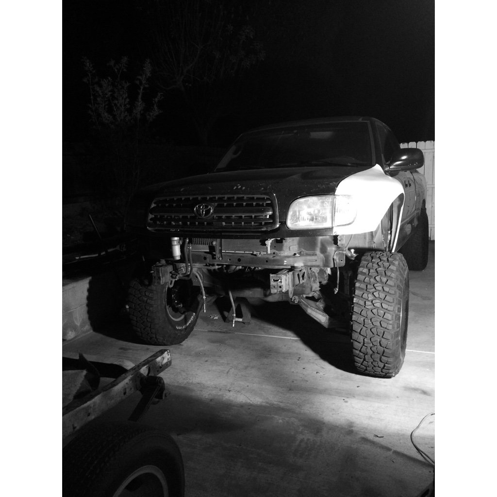

    joined the tundra side i see
    stock bedsides will pull surprisingly far by the way, i pulled mine enough to tuck at full bump with links haha i love it

    Yea I did haha, not bashing on the first gens, but I knew I wanted a little more as far as motor. I plan on pulling mine as well!

    Love the kit, hope to see a first gen one!
    Why are both uniballs vertical? Does it affect your turning radius?
    and wouldnt changing the inner steering pivots with a wider rack affect bumpsteer?

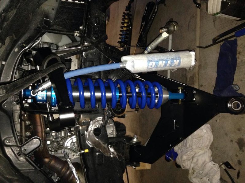

    Getting ready to setup bump height, should I do it without coilover installed and set bump before heims/cv's bind? Or remove the spring and go off the shock being collapsed? Something about cutting up a brand new truck just feels right

    Where the shock bottoms out is the most important, take the spring off and cycle it with the shock
