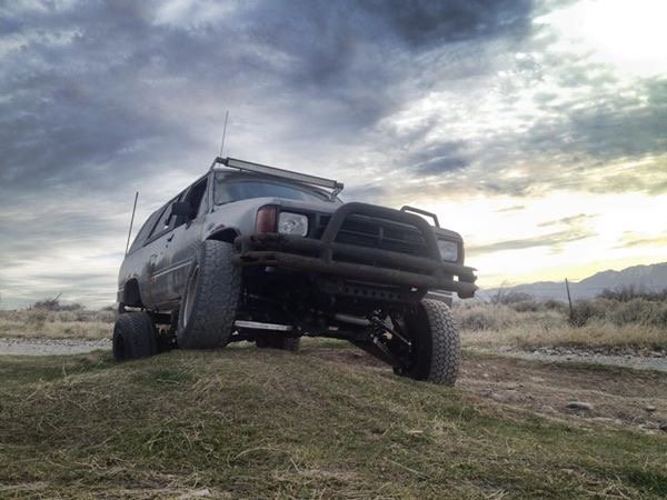

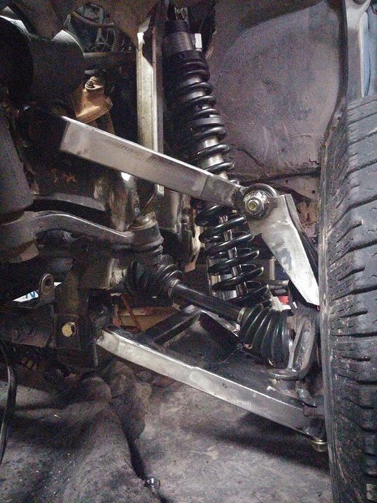

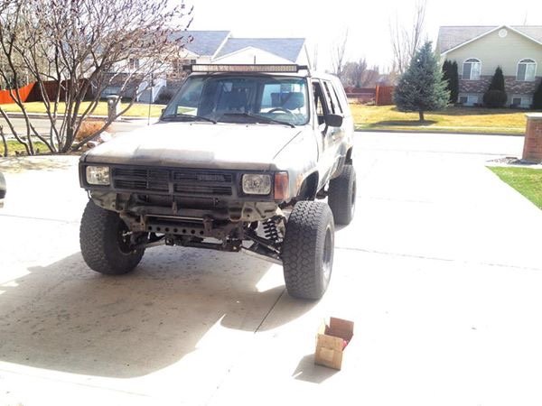

    Yesterday my buddy and I took his 1st gen 4Runner out for it's first real test drive besides just going around the block a few times to align the front end. 1987 4Runner, J-arm upper with horizontal uniball (axis of the cup) and heim mounts, A-arm lower with vertical uniball and bushings, heim steering, 10" coilover. We haven't done a proper suspension cycling yet but last we measured it was pulling 14" of travel with the CV limiting up travel and the LCA uniball limiting down travel. Plan is to lower the LCA mounts to pull more down travel which he thinks he can get 2" more droop. He doesn't have an account on here so figured I'd share, it's a gorgeous suspension.
    Like I said, this was the first drive across town--nothing is even painted yet so there's a lot more work to do, but it feels wicked smooth already :D

    Looks good! ^^ just remember travel numbers aren't everything. A properly valved truck with 12 inches will outperform most bolt on stuff.
