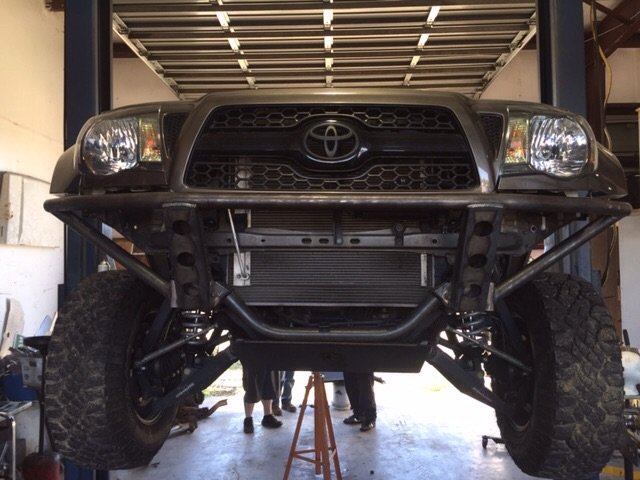

    Finally found a decent fab shop in NC

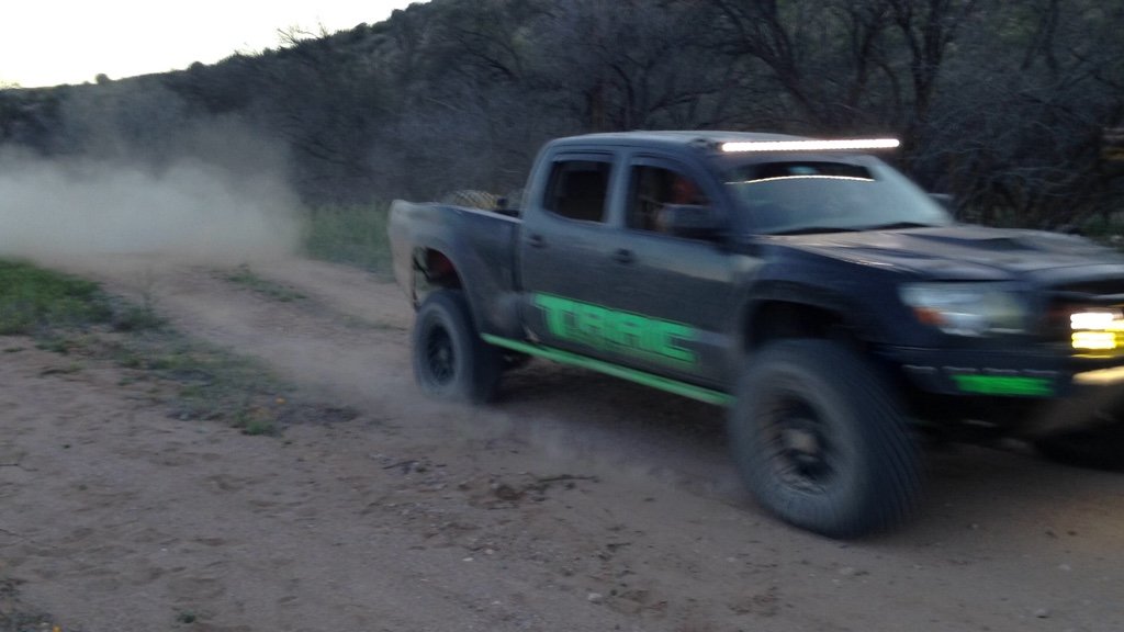

    Truck looks like it handled that pretty well.
    That person with the camera though.... that was a pretty dangerous spot to stand.

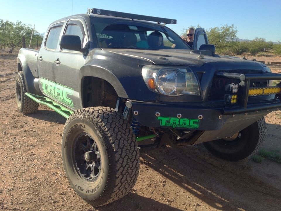

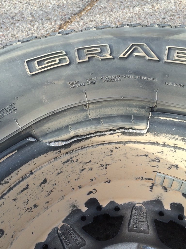

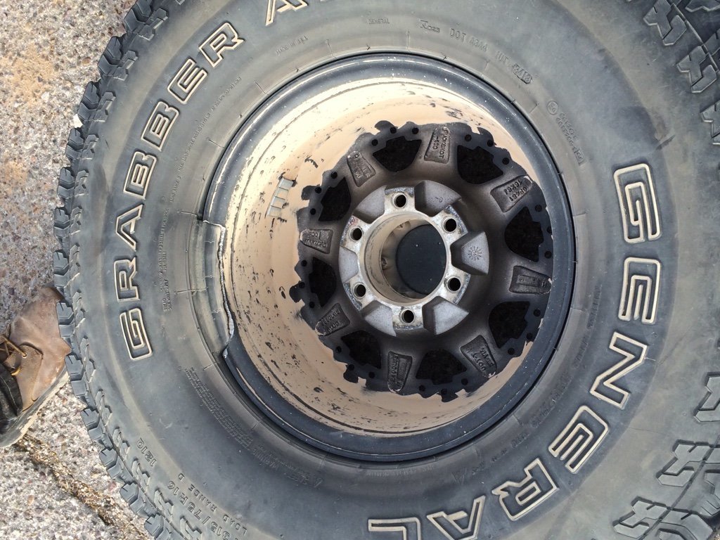

    who bit your rim?
  14. Mar 31, 2015 at 7:29 PM
    SconnieHailer
    SconnieHailer PutterClutch
    Aug 26, 2012
    #85590
    9,765
    Marc
    West Central Wisconsin
    2012 TRD Off Road Double Cab V6 6Speed
    Shit man that's a gross rim failure. Time to change mfgs based on your track record... I vote Stealth, Konig, or Method beads if you care for my opinion :) Nice pics by the way!

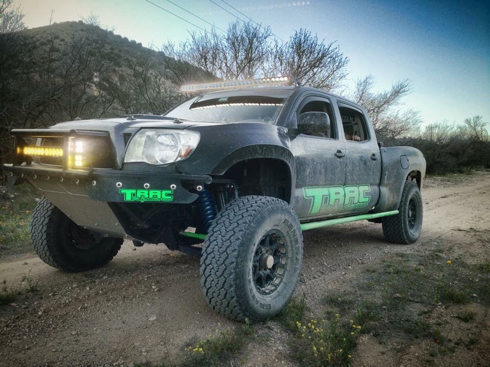

    Trucks looking sick man!
