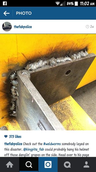

    LOL, same here, now I've gotta add that to the list of things to look at when I pull jprich's truck back in the garage next month. I boxed it in and plated some areas of it but still, all this talk has me a bit paranoid now.
    Out of all the stuff I've built, what I did to his frame horns are the one item I'm just not willing to show pictures of. LOL, the added material is stuck there and not going anywhere but boy is it ugly!

    ^^^^ hahaha! Yeah last night when I posted the pics I was being very selective. Some sections looks like I have fingers growing. I need to get a better light when I go to finish it off. I still have a lot of clean up to do. :facepalm:

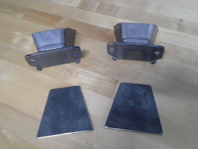

    The rest of my perches looked good but my ears were gone.
    Pic of the mounts Halo made for my truck in the link below.
    http://www.halosupercars.com/blog/news/taco-update/
    They have done a few set for other since and added ears to make it easier to position the mount. Pic below
    Give them a call or shot an email and they will make more.
