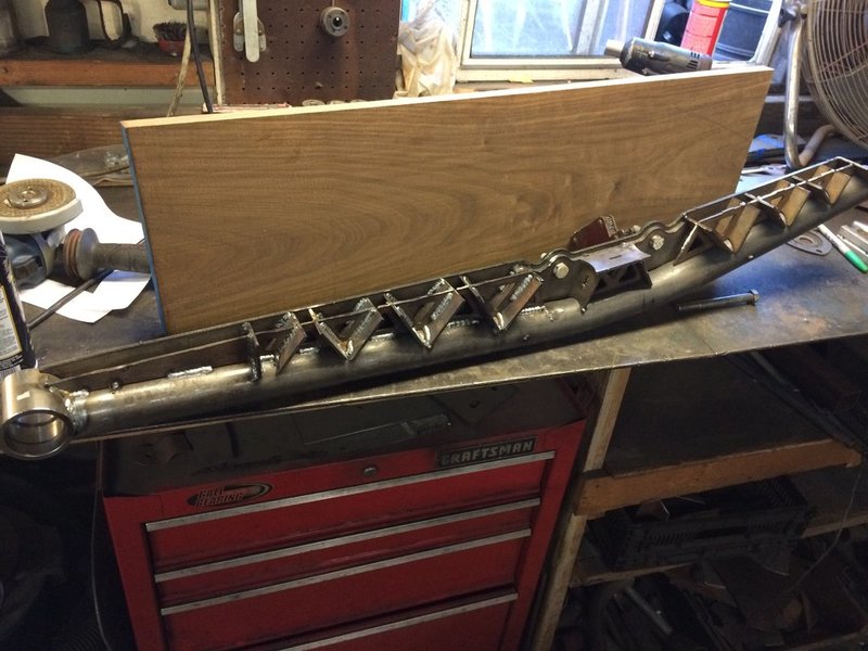

    Kyle and Jeff, why design them with the diagonals not connected at the top? This is not criticism but a legitimate question. Does the gap not open it up to a bending moment? Also if they came together at a point would it not let you weld the "point" and the top "cover" plate all in one weld vs. 2 seperate welds? Otherwise they look nice!

    Honest answer would be that I drew this up on paper and gave it to my buddy to input onto cad for me and that's just how he spaced them, haha

    My reason being is if these ribs were to meet, the top plate would have a much wider weld gap to fill. I spread mine out to spread out those weld slots. Also, it was easier lol. If these parts were laser cut, it would go together like legos. There is a limit on a plasma table as far as precision goes. It took a lot of measuring and test cuts to get Tylers ribbing close, and he still had to grind it out a bit. I'll be adding a 3rd rib to mine on the next set for peace of mind. Then we will see how good my drawing/cut work is lol. Fingers crossed.

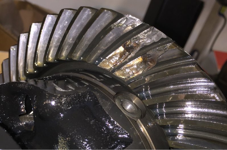

    Anyone know of any not-stock rear ends for sale? Just chunked through my fourth set of gears. ImageUploadedByTapatalk1430446349.609109.jpg
