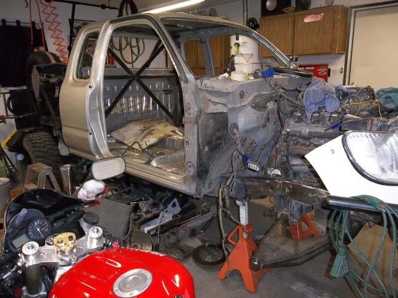

    Jordan is putting in a new tundra rear end on his 2nd gen... I believe the 10.5".... Another thing to remove is they r 5 lug too

    You are not Supercharged BTW Matt, looking at pictures, there looks like hoses running right where you have your crossbrace at. Might just end up having to go with an engine cage, or have a new hood made that's got more clearance

    Where there is a will, there is a way. A plated and boxed cross member can be made to go around anything. On Gary's truck, I went over his intake and some throttle linkages. Hard to tell from this photo however.
