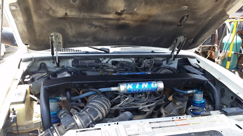

    Dang those are some tall coil overs! 12" travel kings?

    14", but it's not a tacoma lol

    That was built when they had a supercharged truck in the shop making sure there was room for the charger when I add it in the future.

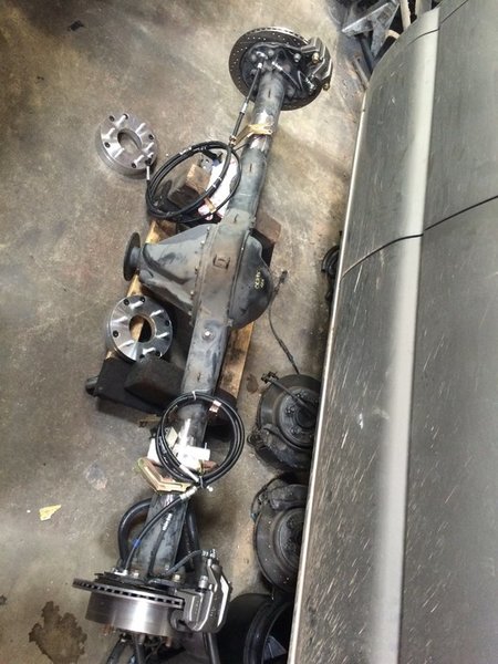

    If you guys had the choice between the Ford 9" or the Tundra 10.5", which would you pick? Only reason I ask is because there are a few trucks at the local (and only) junkyard and they have complete axles. People who work there aren't out to make money on them either so figure could pick either for fairly cheap.

    A 9" is going to be stronger even though the 10.5" is a larger ring gear due to the design. A 9" has an extra pinion gear support bearing that keeps the gears from deflecting away from each other

    I like the tundra because its toyota. Brake lines match up, wheel speed sensors fit, its a 10.5" diff, ruffstuff makes a ballin housing for it, think its a 36spline and the axle shaft its self is super beefy, gear ratios same as the tacoma, and its wide as fuck. All u need to install one is the wheel adapters, and a drill to drill out the pinion flange. Downside is the cost but i think the easy install makes up for it

    i belive about 73-74"

    So the 9" is stronger, but the 10.5" is more user friendly. Guess that goes down to which I can find more of, probably going to be the 9"

    Look at the cost. You can find 9" complete for 3-500$ all day. Replacement parts are way less expensive as well.

    Junkyard housing's all day long. Econoline and F series trucks are easy pickings and are plenty wide. IIRC the econoline is 69" wms-wms

    Im running a 68" econoline housing, semifloater, currie sportsman 3rd member and 5 on 5.5. I'm into it about 1200$ including gears and spool. Not bad at all

    An makes sense now. Was wondering what engine that was, and figured it must have been the old 3.0 v6 in the older trucks.
