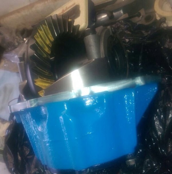

    Yay for broken racks

    Ouch. Just weld it back. Hhhhaaha

    I was actually thinking about that haha

    Hahaha. Jb weld it. Should hold for 100k.

    I wish id kept the two racks i did that too. The case was all that broke. TIG welded would have been fine.

    I'm really considering it.. Don't feel like forking over cash right now

    I don't see why it wouldn't work. Long as everything else is fine.

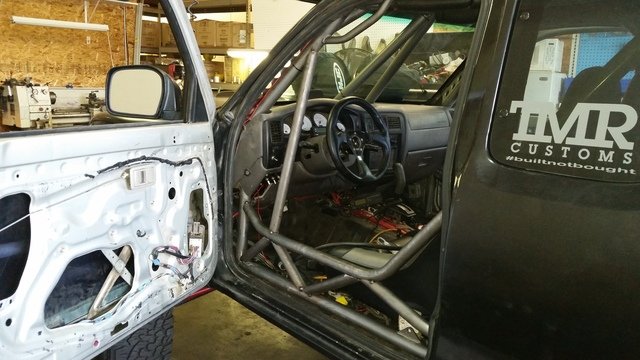

    Decided to redo my door bars today. So much nicer then what I had20150525_161217_zpsig1nk2zn_8cc61dd107cf755935d21073695b3b7c872e2e7a.jpg

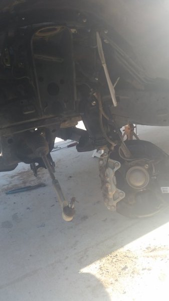

    everything ripped out20150523_175738.jpgand everything new installed the shocks were backwards which we didn't realize till we were done:facepalm: but everything ended up working out gussets go in Wednesday and an alignment what you guys think?

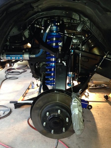

    I could be wrong but I think your uppers are backwards? I had the same kit and it looks like the unibal is pointing down. As far as the coilovers being backwards just loosen up the fitting and clock it where u want it unless the stickers on the resi's being upside down bothers u

    image.jpg Here's how mine was

    both of your guys uppers are on the same way. truck is facing a different direction. LOL

    Not the way the arm is facing but look at his unibal, he needs to flip his arms over and swap sides. The way his are right now he would have almost no down travel

    Are there straps hooked up? Looks like its at full droop and not at ride height? The whole arm is suspended

    Yea thays your driver side against my passenger they both are the same as far as I can see

    I'll get some closer pics of the uca tonight for yall to take a look at and tell me if I fucked up haha

    It's fine, unless both of you have them on backwards lol. As said above, drivers side vs passenger side. Plus you don't have limit straps on so you're drooping more than the other guy causing more uniball to show.
