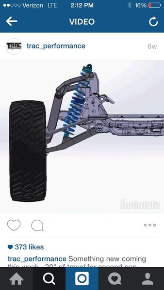

    image.jpg I'm about 5 over runnin solo's kit here's a recent cad

    Why use a weak factory bucket that always bends?
    Cut it out and do a shock tube. You're going to end up that way eventually.

    Cause it would be a lot easier than cutting out inner fenders and relocating everything under the hood. All I would do is build a cross brace from bucket to bucket and be done. I see what your saying though and appreciate the help

    Short bodied kings are only an 1" shorter. Same shock with just the cap over. The Dimensions are 27.37 ext and 17.37 collapsed. The only shock that works without a pocketed lower is swayaway with modifying their top cap to fit and notching the coil bucket for the resi. I'm working with fox right now to try and find or make a shock that will work with stock coil bucket. But even with stock coil bucket the inner sheetmetal limits travel so might as well cut it all out and make hoops or an engine cage.
    And might as well run a shock hoop and crossbar for longer shocks because motion ratio and spring length with help make the front end handle better.

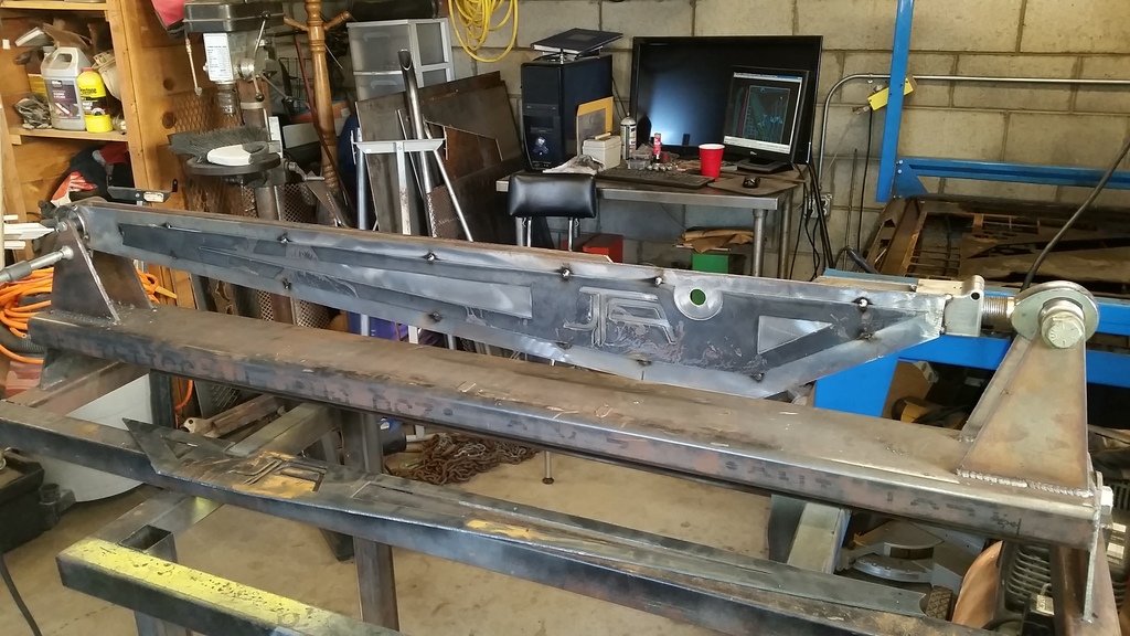

    Links coming together for the dcsb build. Will be off to powdercoat tomorrow or Thursday.

    Those look good. They are just going to run coilivers?

    Yes. No room for a bypass with current axle/wheel configuration.

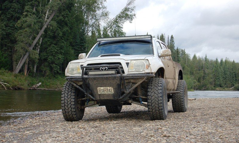

    So can someone give me some advice on frame horns vs tubing style horns on a front bumper. I understand the frames are thin and you want the bumper to fail before the frame but kinda thought using mild steel would act as a crumple zone. Still not sure on the dom vs mild but truck is finally getting the kit installed next week and trying to better understand the merits of each.
