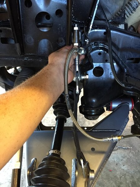

    Guys, is this where I weld on my limit strap?
    I feel like I should just weld the tab closest to the top of the frame as I can because it's adjustable... Anyone got input?

    Weld it anywhere you like as long as the strap is going in a straight line when tensioned, and leave enough adjustment to comp for some slight stretch 'n youll be solid..

    Meh I guess I'll do it the correct way and put the whole suspension together. Just didn't want the stupid coilover and spindle and all that stuff in the way when I weld and paint
