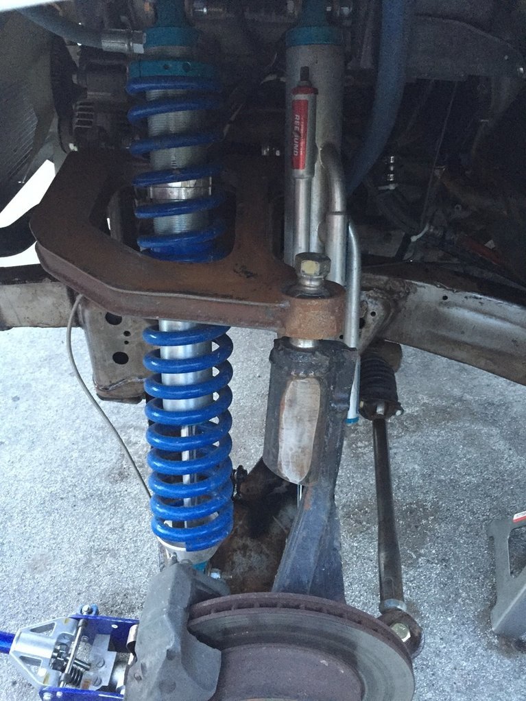

    Testing the waters, my ESB kit might be for sale in the next few months. Custom boxed upper j-arm (I believe it uses factory mounts, but makes room for a bypass), stock 2wd spindle with ESB gussets and steering arm mods, boxed lower with outer uniball pivot. Fits first gen 6 lug trucks and doesn't retain 4x4.

    It's not a j arm if I remember correctly. Just a boxed upper arm.

    It's a j-arm styled boxed arm that appears to mount to the stock-ish locations.

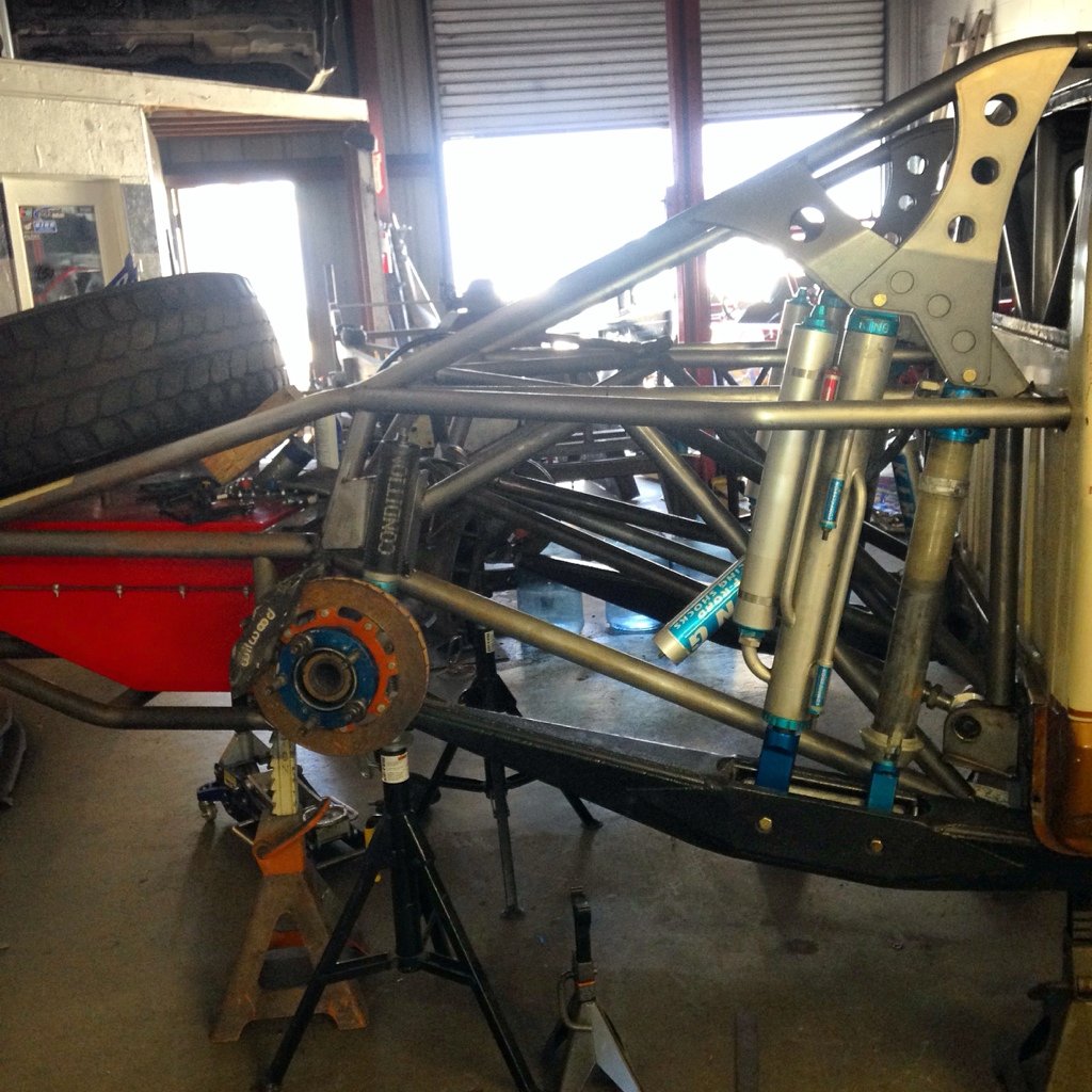

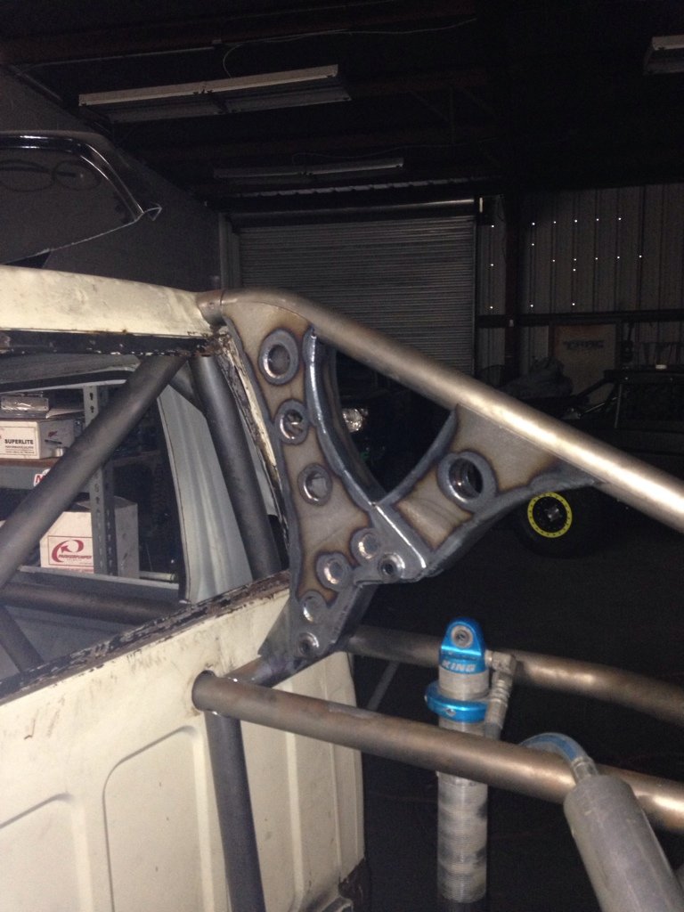

    Some shock mounts and backhalf I'm doing
