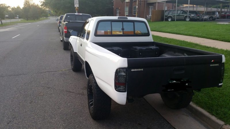

    expensive. stock gusseted 5 lug spindle, balljoint lower, stock gusseted rear end. nice looking truck, but I think its in the 9 range.

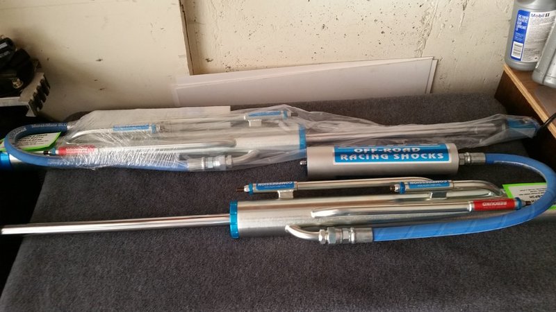

    Got the 16" triples back instead of the 14". Mounting on a basic bedcage, not sure yet if inside or outside the frame rails. Can one of you guys please suggest how to mount these to the bed cage? I have lower shock mounts for the axle but am unclear on what all I need for the top, and from where?

    For starters, you going to need basically an entire bed cage to mount the shocks. and you can't really just throw them on it hope for the best. If those shops aren't close to where the sweet spot is, it could become a little difficult to valve them properly. If I were you, I'd spend the next few days at least just reading everything and anything you can about shot placement for a leaf spring application.

    Any suggested reads? I've been researching for a bit. Already have my tube bent for the cage. And I get the sweet spot and how you map it out with full droop and stuff and where the lines intersect. Its not going to be easy i understand. I want suggestions on how to mount the shock upper to the cage for now. Is there a kit I can get or something that can help with getting the upper shock mount secured to the cage or do I just fab something up?

    I think just shock tabs mounted at the right location and then gusset the somehow...or build a good box with holes drilled to run a bolt through for the shock bolt and make sure its nice and gusseted into the cage

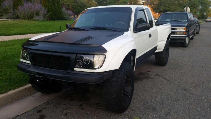

    cut that front bumper in half in the middle, widen it, and add a skid. it'll look damn good and match the width of the glass.
