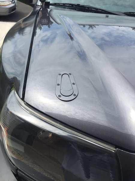

    I just did the hood latches. There's a thread for them on the forums. I put a bunch of pics in it plus on my build thread.

    You run those in addition to the oem latch?

    Yes I did. The main reason why is because my core support is no longer straight. There was a gap at the outer edges of my hood that at speed would make my hood start lifting up and bounce everywhere when off-roading. These latches cured the problem for now. The only real fix is to eliminate the core support with an engine cage.

    My hood lifts a little on the edges with my hood vents at speed but nothing unbearable. They look cool though (Latches).

    Look up aerocatch and they have an offroad version and a regular version i was reading some people were breaking the standard ones. Belive they are the same price too, the offroad ones just have stronger pins i think
    Edit*
    http://www.aerocatch.com/aerocatch-xtreme

    I tossed the aluminum pins and ordered some steel ones. Also I recommend using loctite, lock washers, or nyloc nuts rather than the regular nuts they come with. I had my hood come loose with the vibrations.

    The Aerocatch kit I got came with nyloc nuts and backing ring for the latch to bolt on to. But I do wish I got the steel pins. The Aerocatch Extreme is the kit with steel pins.

    The hardware for the latch itself on mine is also nyloc nuts with the backing ring. The one I had come loose was the pin itself.

    coastfab.com carries the steel pins. Can't order online but just give them a call. The part number is 117-1043.
