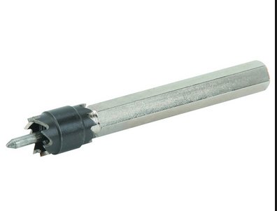

    Cam tabs are bitches. Well the front 4 at least

    If you are talking about difficulty removing them spend the $ for a nice spot weld drill bit kit...it had all of mine off in 30 minutes, no air chiseling or grinding etc needed.

    I am , I drilled em out and then taking a grinder too em. Not that much of a pain.
    The front ones are the ones that they spot weld em on the rear 4 are just welded on the outside and top and they took a minute. I'll never have you deal with cams again so I'm not worries about the tool. Thanks tho man.
