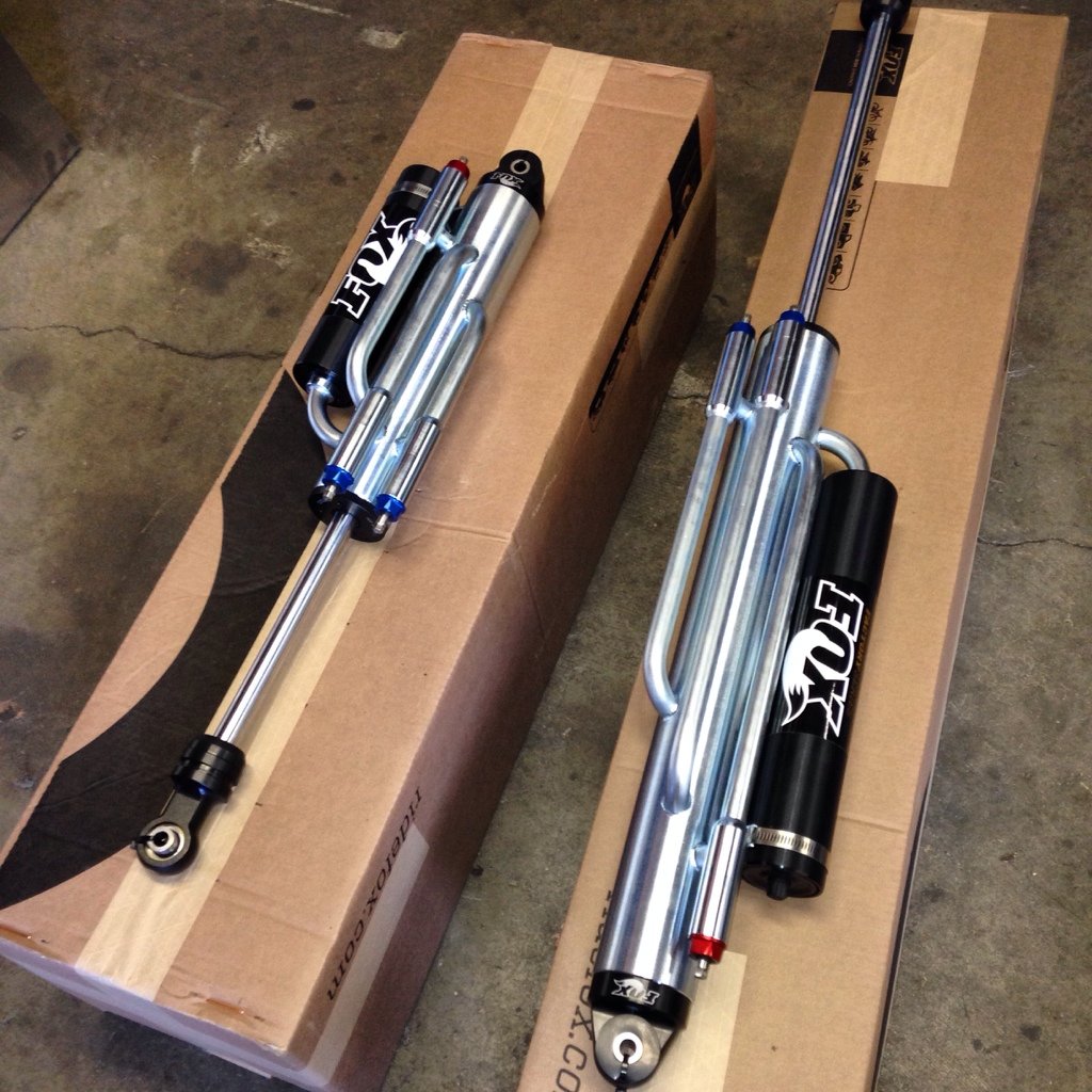

    Put some new shocks on a tacoma yesterday

    I started tearing into my coilovers right now, but the piston has no bleed screws, do I need to get these from fox? How do I cover them so I can leave only 2 open? Let me know if Im completely misunderstanding this. Also any advice on setting the ifp?
  20. Sep 27, 2015 at 5:16 PM
    TC yota
    TC yota Well-Known Member
    Feb 4, 2010
    #30692
    2,127
    Tyler
    Escondido
    Ha
    As in in the small threaded holes are all open? If so then yes I would get the screws to plug them. They may not have any holes, just varies. Also if they are foxes, you may have to up the compression a bit.
    Ifp I just normally bottem it out on the hose end before I assemble everything. When you put the shaft in it will push the ifp back a few inches
