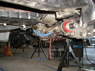

    is this codestirr? if so did you try that steering shaft mod yet? It made a difference for me. I also stopped by richer racing today to talk about modding the stock rack like he did before on this truck
    0BF3BB77-AF81-450F-BA01-1BB749593CBE_zps_0b35da1c0b5b8f702de127882edd3ce6cadfdd9c.jpg
    this next pic describes what he did
    Unfortunately Jonny from richer racing said that was the only tacoma rack he ended up ever modding. Didn't say much other than he wouldn't be willing to do that rack and pinion mod anymore and it ending up just not working out for some reason. For now I'll be doing what khris (sirhk100) did on the TPR racetruck which was adding a 4th mount to the rack to strengthen the rack and help with the splitting down the middle which is where I've seen 90% of them fail.

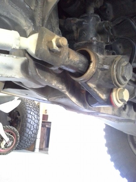

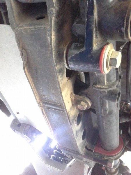

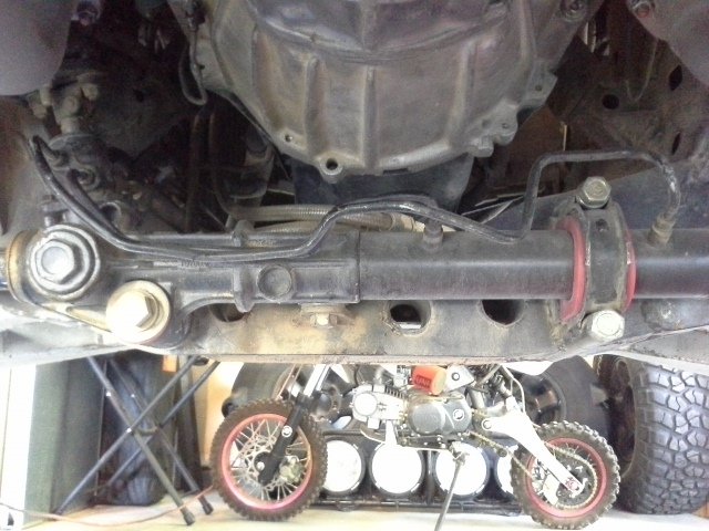

    I've never posted any pics of this but figured it would help you guys out. Here is my setup as far as steering rack/custom crossmember for the rack. I have been running this setup since around 2006 and even though I still go through about 1 rack a season, I have never had one split in half or break on me. All that ever happens is they start puking grease and the steering gets sloppy. I run the Total Chaos red urethane bushings on the outsides and a custom machined aluminum bushing on the center.
    A lot of people claim that bumpsteer is a problem due to the rack being wide. I do agree it makes getting clean steering geometry more difficult, but definitely not impossible. My truck toes in about 1/16" at full droop. No fancy rack modifications or hydraulics. Just good ole fashioned steering/kit design with a lot of thought and math put into it.

    Nice job on that rear crossmember Ryan!!!! I learned first hand after this V2R why yours looks sexy like that! Crackedy crack OE stuff!!! LOL
