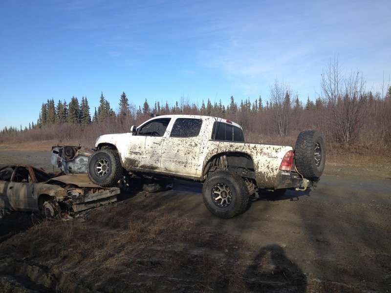

    Any reason why you mounted your springs on the outside of the rail as opposed to under?

    The wider the better. He's more than likely going to build shock mounts that are integrated into spring plates. Truck stays planted better, a little bit less body roll and overall better stability.

    Also more bedspace and the gas tank is less of an issue if you lean the shocks back a bit.

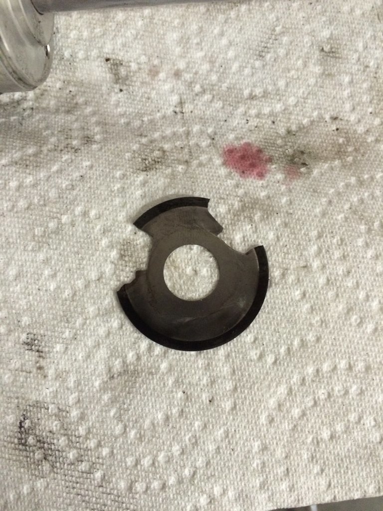

    Where's the best place to buy rebuild kits for Fox shocks?
    and...
    these shocks have been blown for quite some time. Should I expect to find additional damage in there or will new seals, new fluid, and a recharge be reasonably expected to do it?

    Hard to say until you open them.
    DSM i think is the best place. @Downsouth Motorsports

    I don't like throwing money away, but taking the shocks off, getting the coils off, tearing the shocks down, only to find out that I need more parts is a situation I want to avoid. I've never done it before so I don't really know what there is to "burn out" from running a blown shock for an extended period of time.
    Maybe a set of those Fox DSC's is the ticket.

    Well, on my kings that where leaking oil, turns out the snap ring had gotten fucked up. Did some damage to the seal housing or whatever. Sorry, not the piston.
    [​IMG]Igor-19.jpg by Monte Nickles Photos, on Flickr
    They still work fine.
    But honestly there isn't a lot that can really go wrong..I'll bet they are probably fine.

    I think rebuild kits and you will be fine

    If it's been a while plan on all seals and fluid. Shims should probably be ok.

    Only other things too look at are your shafts and the heims.

    My truck rejects any shims smaller then .020 on compression
    That was from one trip
